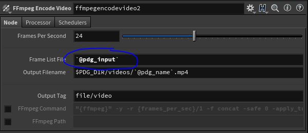

28 posts
Joined: Dec. 2010
Houdini 17.5.229
by default have an error to build video with frame list
to fix that just simply `@pdg_input` works in mine case maybe someone help that
Thanks
