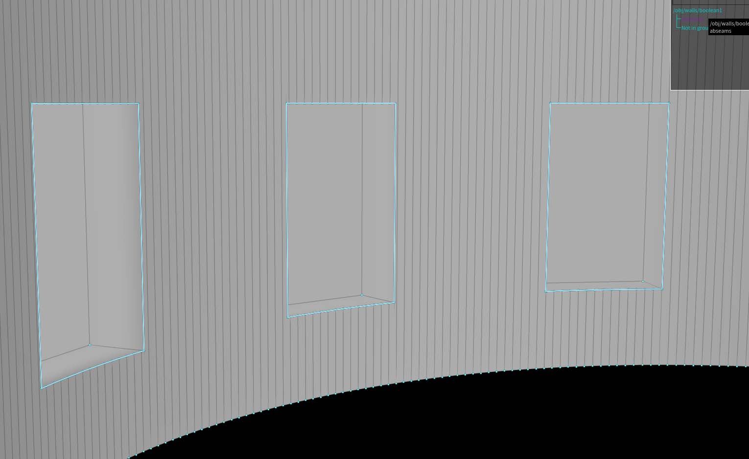

Hi!
I booleaned holes in a wall where my windows will be. I need convert the abseams edge group from the boolean into a polyline.
I've tried this solution but it doesn't work for me: https://www.sidefx.com/forum/topic/35440/ [www.sidefx.com]
I can probably do it with a wrangle but I was hoping for an “out-of-the-box” solution.
-Olivier

Hey Olivier,
in the game dev tools is the tool you need. its called edge group to curve.
Cheers
CYTE
1227 posts
Perfect!
Thanks CYTE.
-Olivier

super useful tool~
and in some cases, the polycut technique shown here can be faster:
https://www.sidefx.com/forum/topic/14838/?page=2#post-302470 [www.sidefx.com]
just add at polypath at the end to connect them.
