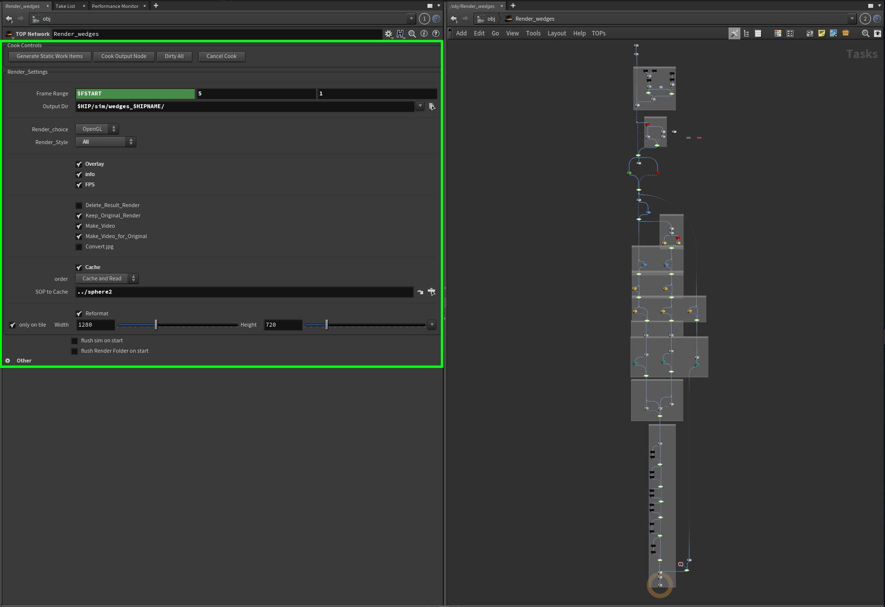

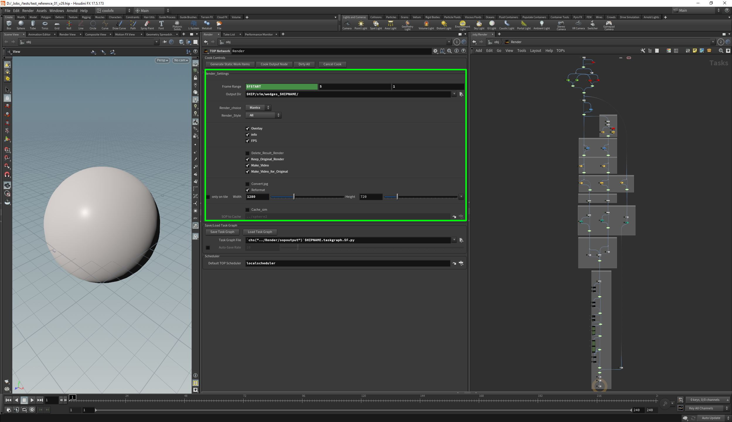

hey there I think this is final tool for :
Wedging
Simulation :
-Cache or Pass without Cache
-Read Cache
Render
-Mantra and OpenGl Preview
-Convertion as Jpg
Post Effect
-Overlays Texts
-FPS
Video
-Render in 3 modes :
each wedge as separated video
each wedge as separated video + mosaic(tile everything)
-Resize by percentage (if You have Big output mosaic video You can Reduce image size with percentage or exact Image format)
Clean features
-Flush Sim folder on begin
-Flush Render Folder on the begin
-Clean sim on the end
-Clean Render result on the end
-Clean everything and keep just video
-Keep Original OpenGl or Mantra Render as sequence
Fully works with Houdini FX 17.5.173
one more You can run that with cmd its there
https://www.sidefx.com/forum/topic/65077/?page=1#post-280894 [www.sidefx.com]
