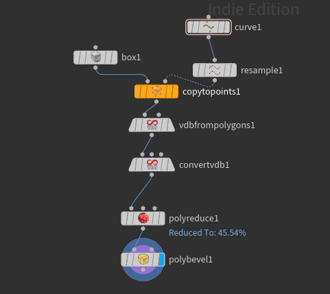

I've got an HDA I've been working on and encountered an issue with polybevel. I've created a simplified version of the tool to reproduce the error. removing the polybevel node from the system, tool works just fine. add the polybevel in and it'll freeze up after you start adding curve points. Do I report this bug here or is there a better system for submitting these fix requests?

I had a quick look at this, and it seems like Unreal gets stuck while building the mesh.
It does seem like the asset is generating geometry that Unreal takes a lot of time to process. It got stuck for me a few times calculating normals and MikkT tangents.
(it's actually not stuck, it just takes a really long time for UE to build the mesh)
