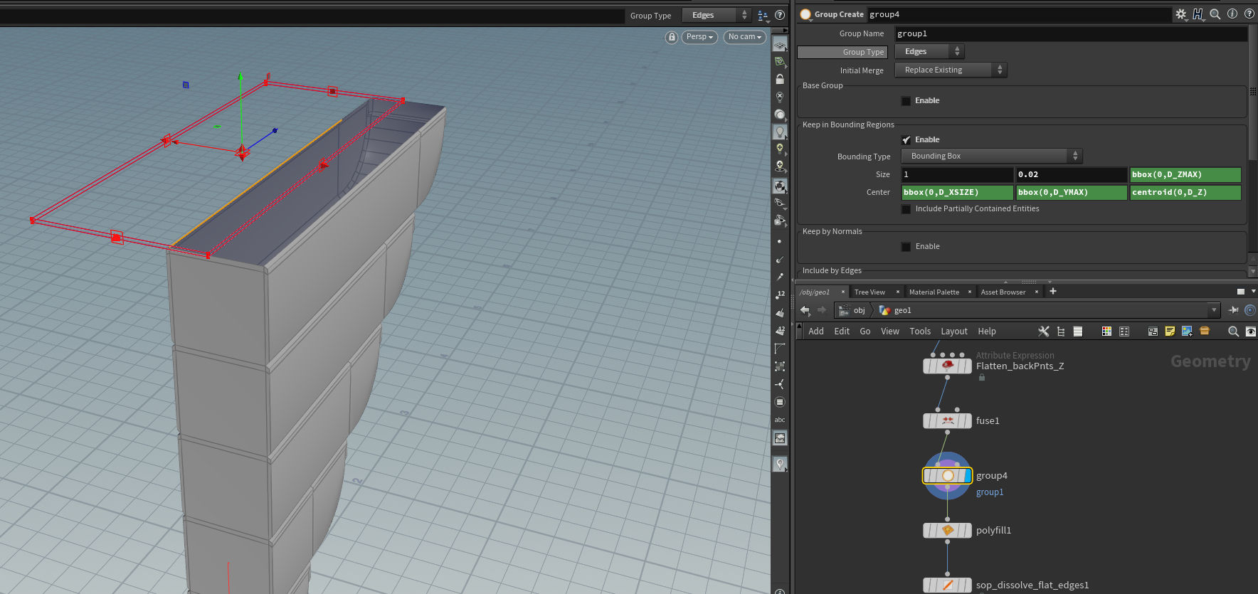

i know i'm annoying with my noobie questions, but i can't figure out how can i set the center of the bounding box of the group bbox region.
i successfully “stoled” the size “automatization” of this bbox, but i can't find any related info about to set the center of that.
please note that i'm not talking about the COG of the actual geometry, but the COG of the bbox of the group bbox region.
questions:
-how can i move the center of the bbox of group bbox region in the center parameter field?
and honestly i don't get these expressions. sometimes i see expression to define the size of an object:
$SIZEX, $SIZEY $SIZEZ
and sometimes (like this case) i see this:
bbox(0,D_XSIZE)
both defines the size (bbox) of the object, but for example i can't use the $SIZEX here.
Thank You for your patient

don't confuse the global or local variables starting with the $ sign and the variables of the bbox expresssion function.
So…In your case, Center of x, I'd say that you want to use this expression: bbox(0,D_XSIZE)
check my 1example pic, showing this, or even with the centroid expression function for the z axis 5(in my example)

I already use the bbox(0,D_XSIZE) to define the size (yeah i'm good ), but you centroid expression did the good thing with the pivot!

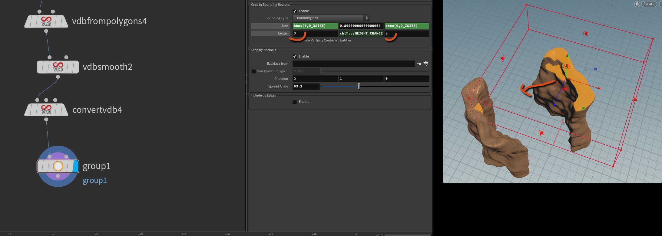

I want to use the longest side of a bbox of a primitive as a measure reference to a parameter of another node
like i have a box with sides 1,2,1 and i want to use the 2 as reference, but of course the numbers can change so channel reference is not an option (i guess)). i attached a shot.

just reference that attribute on your parameter with detail(), point(), prim(), vertex() expression depending on the class of the attribute
so let's assume you have attribvop2 in Detail mode and therefore your ‘box_bbox’ exported attribute is a detail attribute
then you can access it in the parameter of the next node with detail(0, ‘box_bbox’, 0) expression,
or in a parameter of a node in different branch detail('../attribvop2', ‘box_bbox’, 0)
or using spare inputs detail(-1, ‘box_bbox’, 0), etc…
