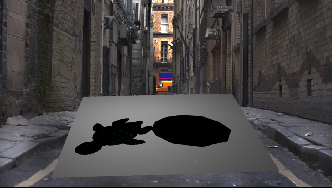

I'm trying out the file but still can't find any way to utilize the data.
The very best that I can get from it is the result shown.
That is by adding the sphere (and rubber toy for visualization) as forced phantoms and the grid as a forced object.
What am I missing here?
Screen Shot 2019-09-16 at 7.16.53 PM.png (828.5 KB)

You need to write out the image plane as an exr, and with the shadow matte shader, you should have white shadows. Then the black part becomes transparent with the exr, and the white becomes your shadows. Then you invert it, and comp it in.
