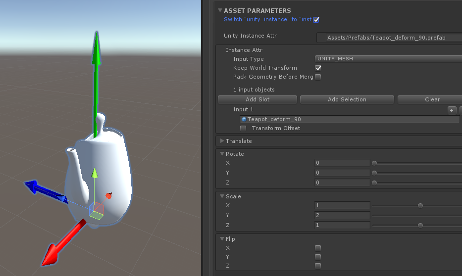

Hi!
There is same bug but with scales. The Y and Z axes are also flipped.
In attachment I upload a new hda file in which the scales and flips are added for testing. And a new package with teapots to check flips.
Thanks!
teapots_deform_package.unitypackage (103.1 KB)
rotation_issue.hda (33.2 KB)
571 posts
Joined: May 2017
That is due to the prefab you are specifying for the unity_instance. In your screenshot, you are using the deform_90 version, which is rotated, so when you apply the scale it applies to the imported rotated prefab. If you change to the regular deform, it should work properly.
