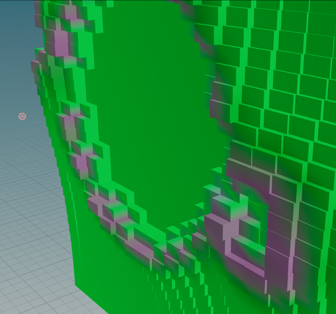

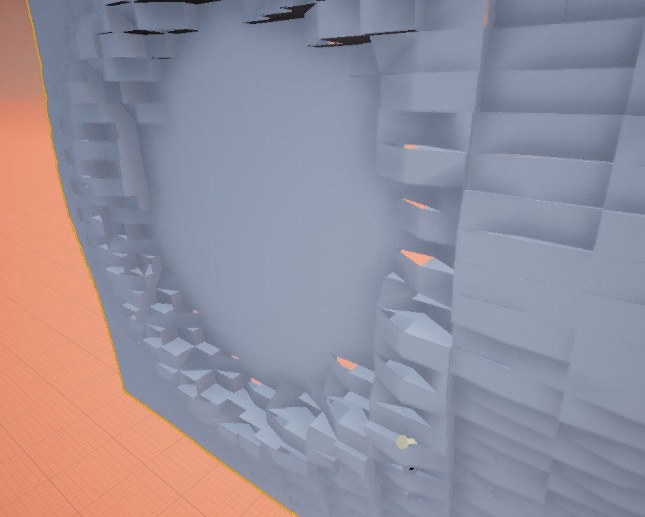

Hey everyone,
I have created a wall that has it's faces extruded based on some rippling attributes.

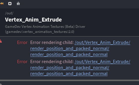

I have tried the soft method because there are no changes in Primitive numbers so I assume the topology stays the same. When I try to export the vertex animation I get an “error rendering child:/out/Vertex_Anim_Extrude/render_position_and_packed_normal/render_position_and_packed_normal” message.
I do see there is a result, but when I import the result to my Unreal scene the result isn't matching with what is in Houdini. It looks like some faces are missing.
This is the same scene in Houdini
Anyone know what I should do? Or should I try another method?

Have you turned off remove degenerates when importing the mesh into ue4?
47 posts
Joined: Feb. 2015
I thought that was supposed to be turned on? I have turned it off but it still doesn't work.
Making the mesh two sided in the material seems to fix the holes. But the extrusion still isn't one to one.

It’s difficult to troubleshoot your issue with the info you’ve provided. That error could mean anything and the static images don’t explain what’s happening behind the scenes. Can you share your hip file?
