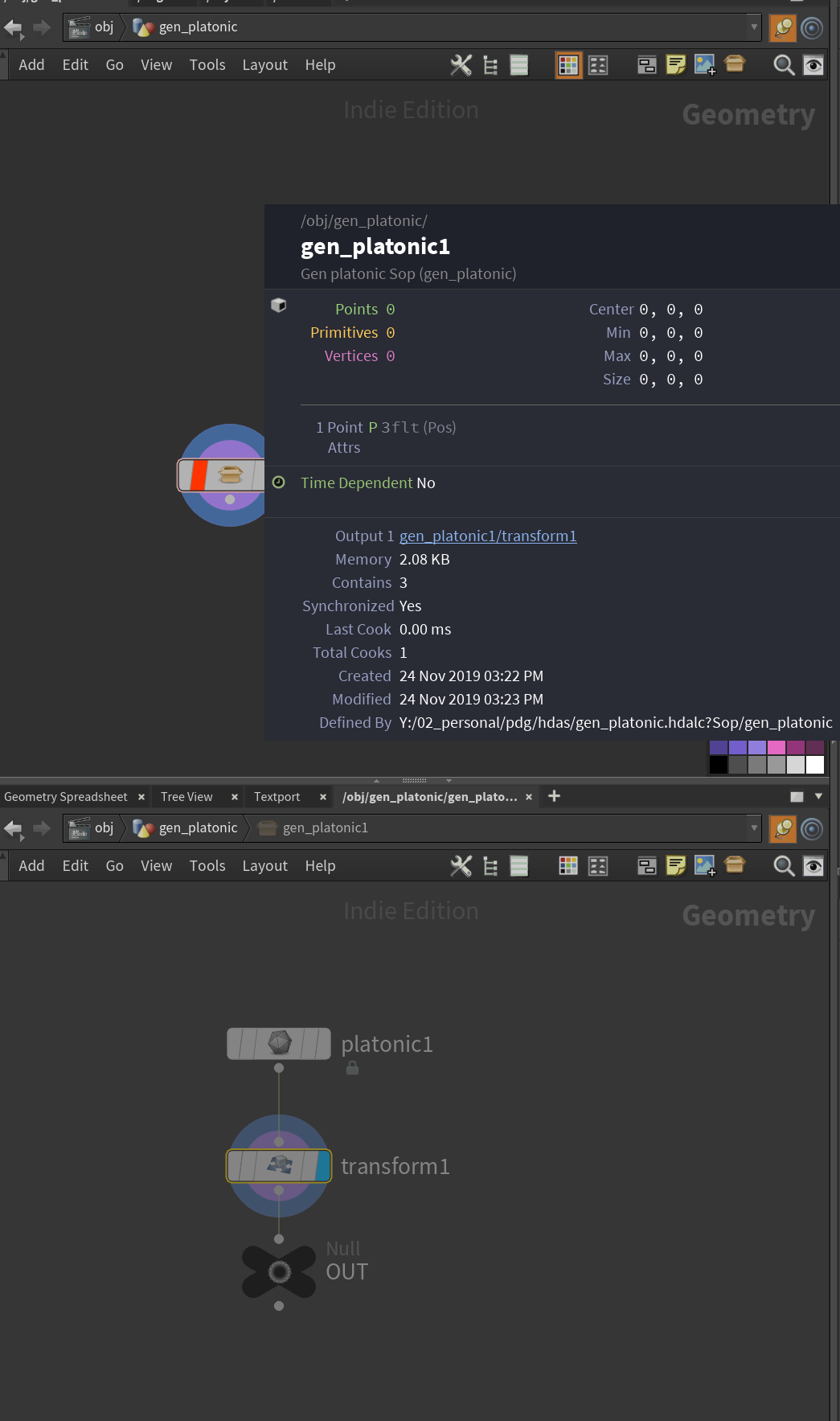

I´m chaging my workflow to make use of HDA Processors, but I can´t figure out why it can´t output geometry (it outputs empty bgeos)., even when testing with the example files.
The asset is a simple HDA with a platonic inside, so no inputs are needed.
I´ve saved the debug hip file, and the hda comes in locked (as if it was missing the asset), but It´s not, as can be seeing in the image attached (04).
I´ve tried the example files but got the same result and didn´t find anyone else having this same kind of error.
SOLVED - There is something in my pipeline scripts that is messing up with houdini.
