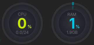

The GIF above shows the Subdivide SOP cooking the toy geometry at subdivision level 6 vs VEX Subdivide (bottom), while the widget updates in real time.
In the next version of Houdini Supercharged I will add lightweight resource monitor widgets that provide continuous feedback on how Houdini is using system resources while you work and build networks.
The widgets display CPU usage and memory usage of the Houdini process in real time, allowing you to quickly see how much of your machine Houdini is actually using at any given moment.
In addition to showing CPU load, the widget also estimates effective core usage. Instead of only displaying a normalized percentage, it indicates roughly how many cores Houdini is actively using. For example:
97% 1/24
This would suggest the current task is essentially saturating a single core.
Whereas something like:
85% 12/24
indicates the workload is distributed across many cores.
This kind of feedback can be useful when building setups, since it becomes immediately obvious if a node or operation is effectively single-threaded versus scaling across multiple cores.
The widget is designed to update in real time and remain responsive even while Houdini is busy cooking nodes, so it can act as a lightweight HUD while working.
It will be available in the next major update.
