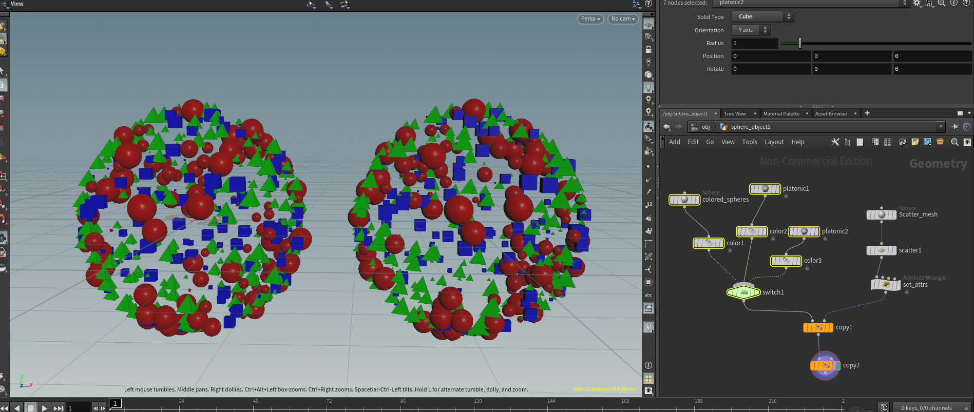

I want to get unique copies of a scattered object as thy don't share the same distribution among them. I've attached the hipnc file.
I've tried to use stamp(“../copy1”, “random”,3)but it seems not working for me. It works in scaling the scattered sphere within the same copy.

Yes, I want to get unique copies with random seed. Actually I have a Coca-Cola can that has condensed drops done with the scatter node. I want to get varsities - in terms of drops location- in my scene.

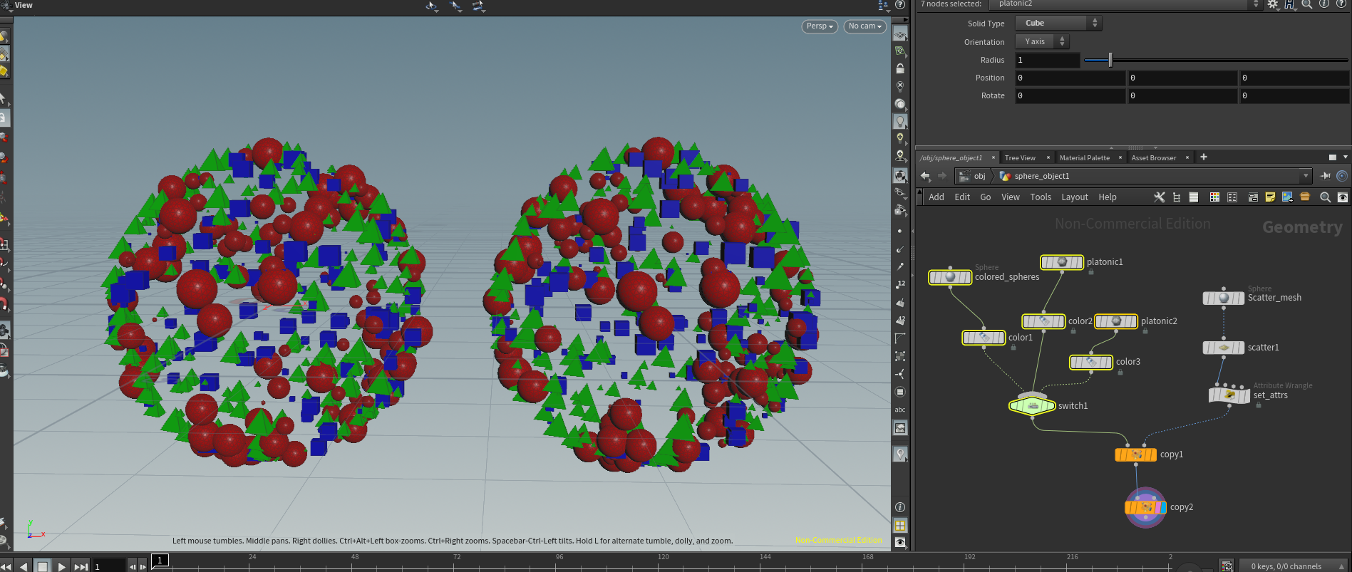

Maybe I wasn't clear enough. I really want to get variation of the whole thing not on the points so when you look at copies they don't look alike. I've uploaded and updated your file to get clear overview.

Stamp expressions only work on the copy input side, not on the template points as far as I know. Why not duplicate before scatter? You'll always get a different point distribution
Just perfect man. Fully answered my question.
