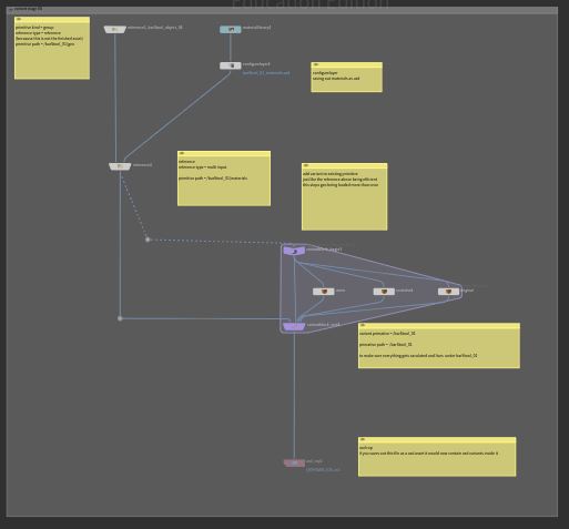

I am trying to work out the best way to store a few HIP files as templates for my students, and for them to be able to auto load them triggered by a custom menu command/shelf button. I have HDA's covered for other things.
Looking at existing shelf tools they seem to be python commands. I have found a few examples of this..
https://www.youtube.com/watch?v=SY6NyECDwpk [www.youtube.com]
Before I start digging around, I wanted to make sure this would be the best way to import hip files like my screengrab.
