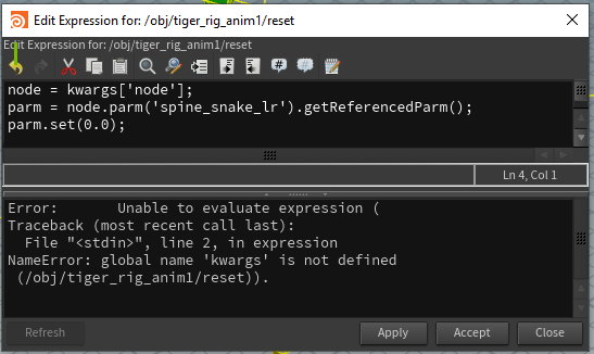

Something is wrong (or I'v put the script in he wrong place) but it shows something like this: (script language is set to python)
I'm missing some imports ? (from what I'v read in help kwargs should be accesible, so this is probably my fault :/)

well, yes, there is no kwargs dictionary passed to expressions and you don't want it as expression since that'd potentially be run a lot of times, set it as Parameter Callback script as mentioned
https://www.sidefx.com/docs/houdini/hom/locations.html#parameter_callback_scripts [www.sidefx.com]

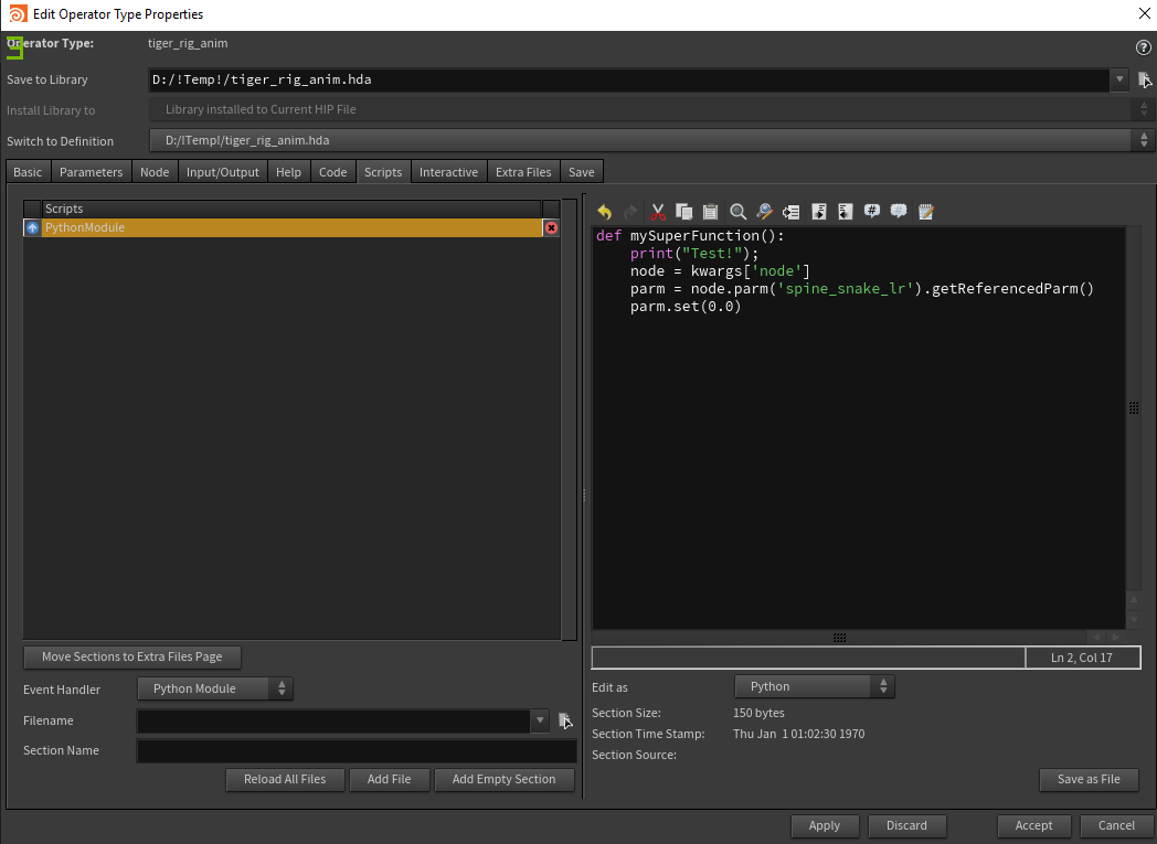

I'm still strugling with it, as You mentioned I'v created callback function:
and the expresion looks like this:
but then the error pops in:
(related line is : node = kwargs)
What I'm doing wrong ?
bellow screnshots of what I'v done.
def mySuperFunction():
print("Test!");
node = kwargs['node']
parm = node.parm('spine_snake_lr').getReferencedParm()
parm.set(0.0)
hou.pwd().hm().mySuperFunction();
return 0;
Error: Unable to evaluate expression (
Traceback (most recent call last):
File "<stdin>", line 2, in expression
File "opdef:/Object/tiger_rig_anim?PythonModule", line 3, in mySuperFunction
KeyError: ('node',)
(/obj/tiger_rig_anim1/reset)).
