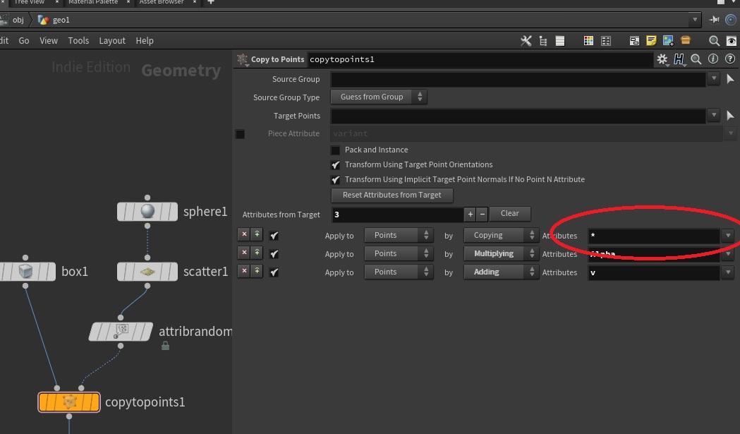

It seems to me copytopoints is not sending the attributes down the chain. Try to write * to the first attributes box of the copytopoints. It does not let some attributes through, by default it says *,^v,^Alpha,^N,^up,^pscale,^scale,^orient,^rot,^pivot,^trans,^transform which means everything except velocity, Alpha, Normals, pscale etc...
