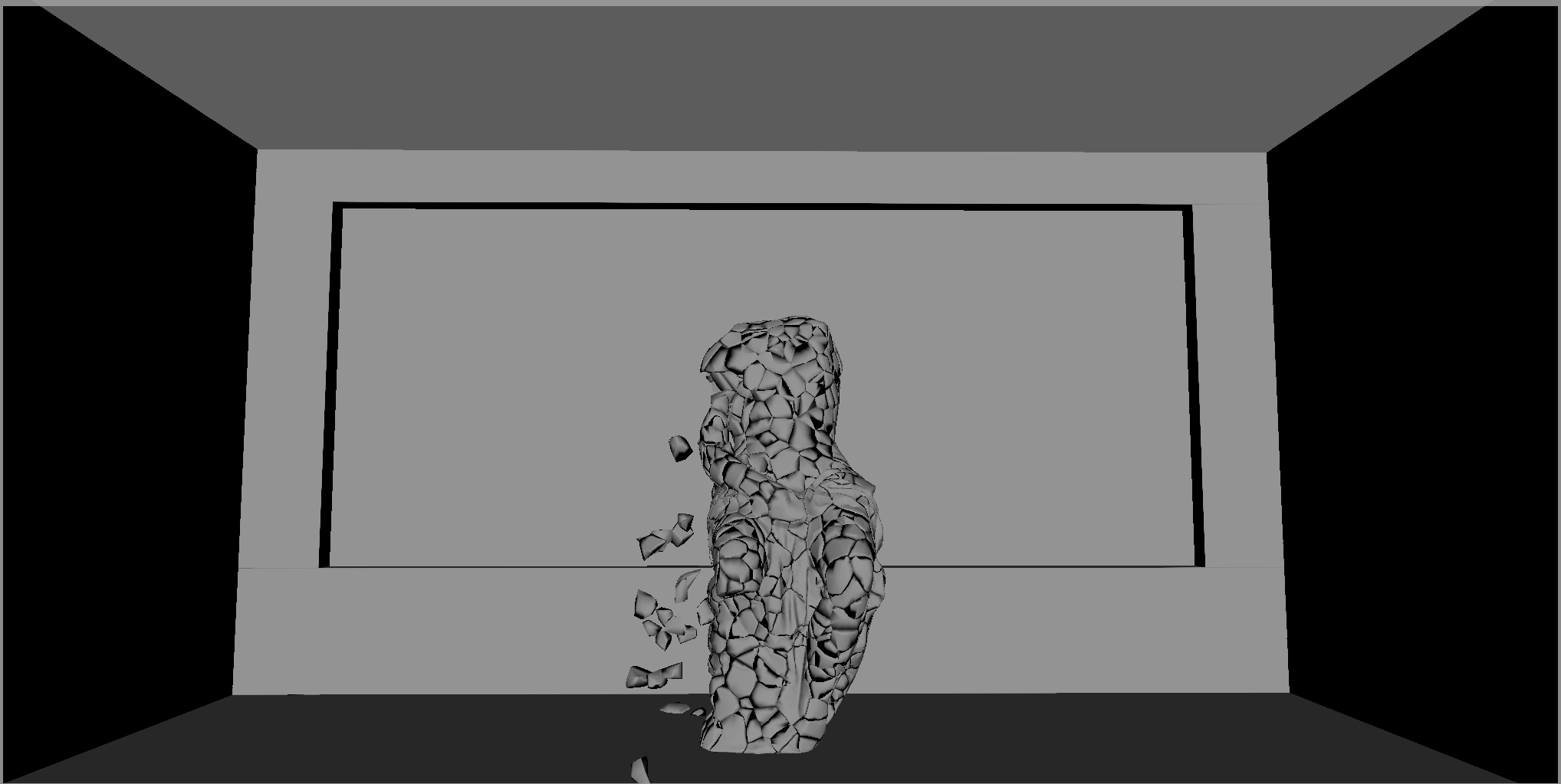

I am very new to Houdini and I am running into an issue when exporting a sim from Houdini to Maya I am getting this what I can only assume are black flipped normals and I am not sure how to fix it.
I attached a pic just so yall see what I am seeing.

How are you importing the mesh into Maya? Are you using the Houdini Engine plugin?
Yes I am using Houdini Engine to import into Maya.

Is “Preserve mesh hard edges” checked in the asset node?
Hey John, Yes “Preserve mesh hard edges” is checked on.
P.s this is the video I was following you guys posted on your website on how to use Houdini Engine with Maya, and even in the tutorial they had the same issue as mine but didn't explain how they got rid of it.

There is a way.
https://ddankhazi.com/2020/08/26/hard-edge-data-from-houdini-to-maya/ [ddankhazi.com]
