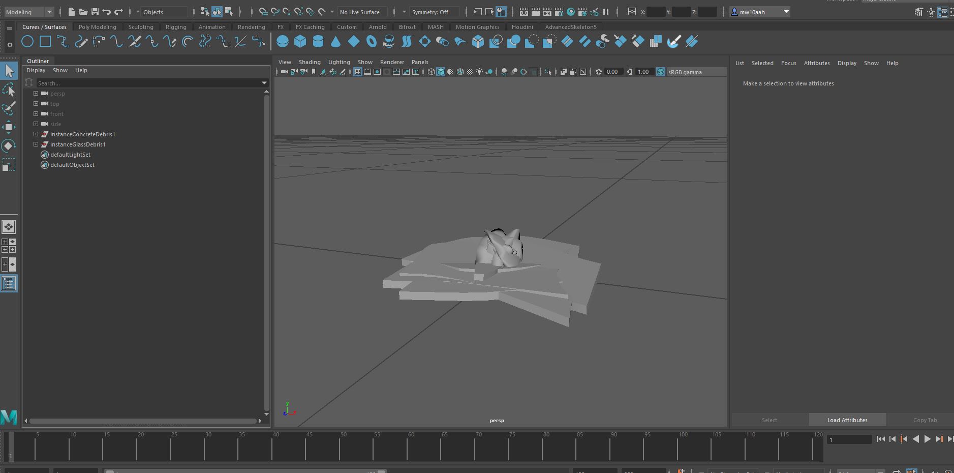

I have a bunch of scattered debris on the floor using instance with spraypaint inside. I am attaching a usd rop set to flatten stage to try to export my mesh (scattered object into the 100s)
Just to test it I am then loading the usd file into Maya expecting to see all the debris scattered over the floor. But I actually see just the raw meshes, not the baked out 100s of pieces of debris.
Is there a workflow I am missing to "freeze/bake/cook" the instance LOP out. How would you use instance if you are using more than Houdini to render usd? (I am only using Houdini myself, but I really want to just load the mega mesh/primitive back into Houdini will all the gazzilionb bits of debris).
I can upload a file, but it is rather huge for everything. All I am really struggling with is the principle of it.
Best. Mark
EDIT: OK I have found a solution if anyone else was wondering. It's not pretty but it works. Under the instance LOP drop down a sopmodify with the export to SOPs option set to "unpack USD Primatives to polygons", then inside the SOP, drop down an unpackusd, followed by a rop_alembic. This Alembic can then be brought back into Houdini and turned into a USD. Phew! Best

Houdini's Instancer LOP should just be creating a run of the mill USD point instancer prim. I would have thought Maya would be able to load that... But that aside, if what you want is a single mesh made up of thousands of little pieces, you probably should have just skipped the Instancer LOP. Create your scattered pieces in SOPs, make sure you unpack any prims in SOPs, and just SOP Import the resulting mesh into LOPs.
Or, if for some reason you still want to use the Instancer LOP, there's no reason to write out to Alembic... Just do what you described, using a LOP Import and unpack the USD prims down to polygons, then use a SOP Import (not connected to the original Point instancer LOP, start a brand new LOP node chain) to pull the unpacked meshes into LOPs as a single big mesh.
But again, I am very surprised Maya isn't importing a point instancer properly...
