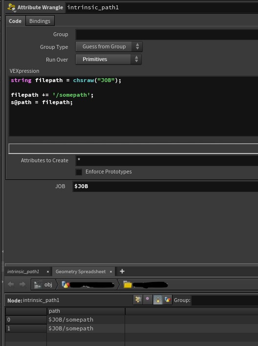

In Python we have something like hou.expandString() to evaluate string with ie. env variables.
In VEX is kinda works automatically, but not when I use chsraw().
Please taka a look at screenshot.
I would like to get the raw string from parameter, do some string modification, and write it to attribute as an expanded(evaluated) version of string. $JOB should expand to path. I am puzzled why it doesn't.
I saw in some old post that there used to be eval() and evals() functions, but they are no more.

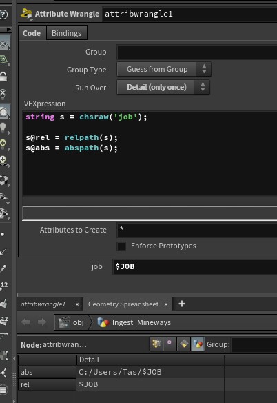

162 posts
Joined: June 2019
tas3d
Here is better explanation of why I use chsraw()
I have this string in paramemter:
$JOB/houdini/geo/GEO_ProcessedSection.$F4.bgeo.sc
I would like to replace '.$F4.' with @primnum.
If I use chs(), then I wont have frame padding pattern, it will be expanded to current frame.
Once I manipulate string, I would like to write it to @path in expanded form.
On the bright side, I got it working in PythonSOP. Just curious what happened to evals() and what is the replacement method.
Thanks!
For this particular case abspath() and relpath() would work.
They expand path variables.

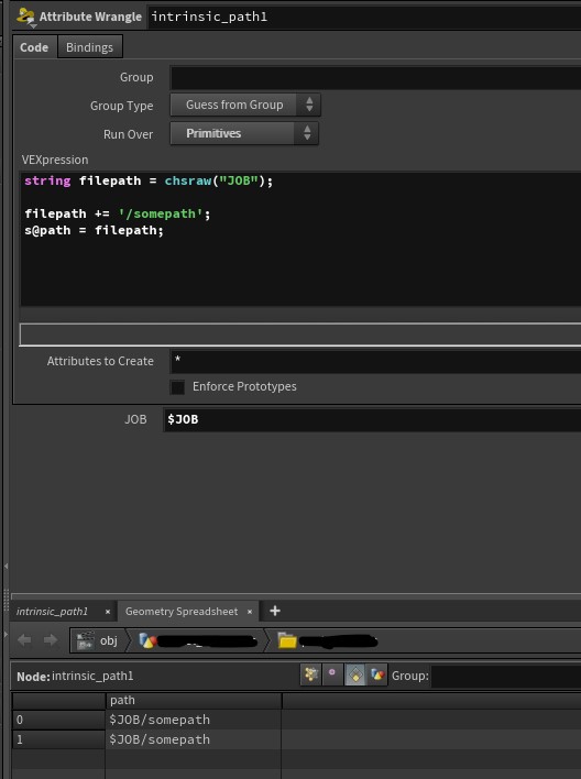

120 posts
Joined: Jan. 2012
Thanks
Unfortunately, not good
Edited by tas3d - March 30, 2021 13:07:18
Screenshot 2021-03-28 135447.jpg (48.5 KB)
Michal Tas Maciejewski @ www.vfxtricks.com
162 posts
Joined: June 2019
tas3d
Thanks
yeah, sorry ) I was confused by the fact that literals are already expanded in vex. Looks like there's no runtime evaluation of string (and hscript in general).
Like you can do something like this:
s@path = chsraw("job");
s@path = re_replace(r"\x24JOB", "$JOB", s@path);
but this would be just for $JOB and doesn't seem viable
