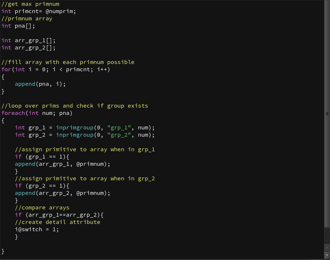

Hello,
I want to check if two Groups are the same, so have the exact same primnumbers. Based on that I want to create a detail attribute that is either 1 or 0.
You can see my approach right here.
What my thought was that I Loop Over the primitives and then check if they are within the groups. If so they get assigned to an array . I do this for each group and then compare if the arrays are the same.
It works, but it is really slow.
How can I improve this?
If the way I approached this is simply wrong, how is the right/better way to approach it.
Greetings Lucca

Well, I would love to see how you can do it in Vex as well just for personal improvement purposes. It can definitely be in detail mode. I am running this code in detail mode too.
Do you mean to isolate the two parts with a blast and then see if the prim count is the same?
Didn't realize that the screenshot was missing a few lines. I updated it now.

Hi Lucca,
it seems like you can compare arrays based upon groups:
int prims_0[] = expandprimgroup(0, 'group1', 'ordered');
int prims_1[] = expandprimgroup(0, 'group2', 'ordered');
i@match = prims_0 == prims_1;

Nice, that's amazing. Just converts this unruly mess I've created into 3 Lines. Thank you very much!
