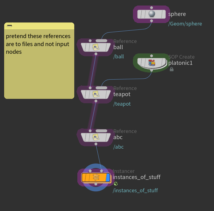

8381 posts
Joined: Sept. 2011
schiho
@jsmack can you provide an example? If I place two times the same reference, it is going to store the two same alembics two times in memory right? But I would like to use the same reference just with multiple transforms (instancing).
Like Andreas said, you do the instancing with an instancer. Only reference each alembic file once, either with a reference lop, or with the stage manager or other device. These are your prototypes. Feed them into the second input of the instancer LOP and set it to Instance primitives. The prototype can be selected randomly or from attributes on the instance points.

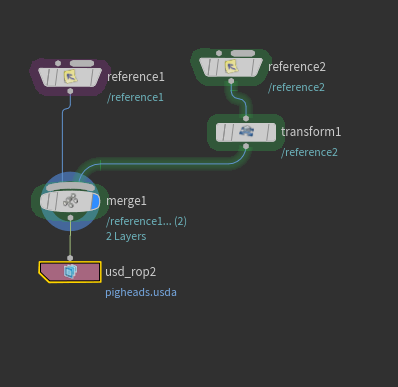

@jsmack Thanks a lot! That's really useful! One last question regarding that, is there an easy way of instancing a single reference and merging it? Basically If an artist was to take a chair and place it multiple times?
8381 posts
Joined: Sept. 2011
On the reference lop, there's a checkbox for 'instanceable'. This lets you reference in the same asset multiple times and it will share the memory (theoretically)
