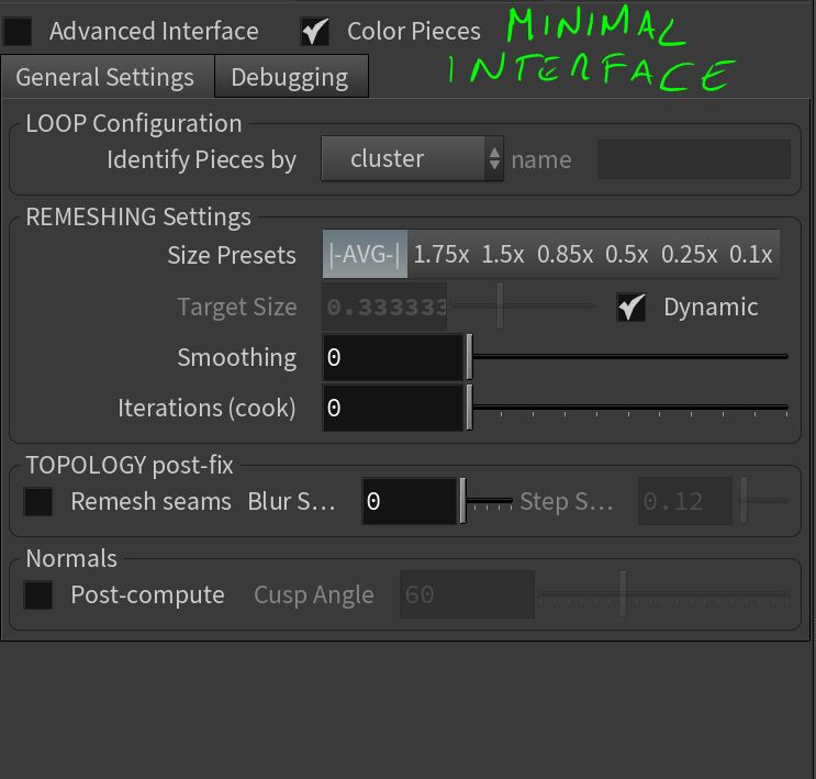

I wish I can open a beta testing phase very soon, so to have some quality feedback to consolidate the tool before the deadline.
I attached screenshots of how the interface looks now.
