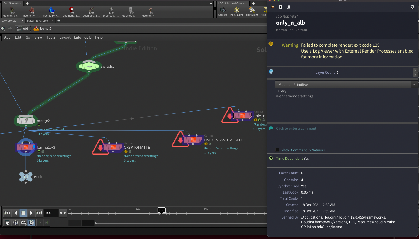

I get this Karma error after few frames.
Warning
Failed to complete render: exit code 139
Use a Log Viewer with External Render Processes enabled for more information.
How can I get to this Log Viewer the error talks about?

I have simplified the render settings to try to debug from what it comes.
Now I only have no Beauty Pass, an N and Albedo pass, and I get the error.
While that same object perfectly renders the whole sequence in a XPU Karma render,
I have logged this as a bug to SideFX,
simple_rendersettings_that_produce_error.hiplc (479.8 KB)
Screenshot 2021-12-18 at 11.11.03.png (438.7 KB)
