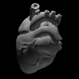

Hey all,
Trying to recreate something like this using vellum softbody or vellum balloon. Needs to be held in place as end product will be either in a hand or on a table.
https://vimeo.com/137055684 [vimeo.com]
Any ideas/tips on how to achieve this?

Vellum tets plus vellum pin to target, playing with the velocity damping and constraint strengths to get it to look blubbery. Using a taper sop to drive the anim.
I claim no physical accuracy here at all, just 'does it look goopy'.
vellum_heart.hip (1.6 MB)
