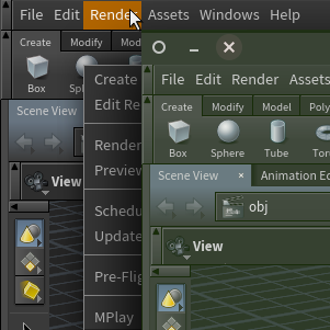

I tested full-screen some more with the script, and the offset is there. It's in all standard menus, even with only one Houdini window in full-screen.
If I configure window manager to hide titles of all maximized windows (to simulate full-screen mode), then the offset manifests itself not only in menus, but also as a gap between bottom edge of the window and the border of my screen.
See: first attachment (houdini-wm-hide-title.png)
(Red rectangles are identical in size, and their height is equal to the height of the hidden title bar.)
It appears those menus are shifted down exactly by the height of a hidden title bar. If you want to compensate for this using an arbitrary number, then this might be a good starting point.
See: second attachment (houdini-fullscreen-offset.png)
(Greenish window is a reference to prove that the offset is equal to the vertical height of the title bar.)
Interestingly enough, while standard menus do suffer from this problem, not all RMB context menus are affected. Those from the network editor appear to be fine (including the TAB menu). Those from the viewport are on the other hand practically unusable, because they are displayed with an offset from the pointer, and will disappear even on a slight mouse movement.
Edited by ajz3d - Jan. 18, 2022 10:57:41
5320 posts
Joined: Feb. 2012
This is what i suspected as well. The problem is to get that value programmatically and even then i can only fix the offset in the network editor coordinates but not the ones in the popup menu or highlighting.
I think this should be trivial for SESI to fix so I hope they do it.

I use fullscreen exclusively with my extension:
I used to have some display issues with Qt fullscreen feature also. Unfortunately it seems to be a hit or miss depending on the hardware and OS used. Before in fullscreen mode the entire screen would blank out.
But now on Windows 10 and CentOS, I don't have any of these issues on my ASUS laptop. So not sure if H19 also improved on this. I know dragging nodes onto parameters used to have an offset in screen space to make it work, but now in H19 no need.
The only issue is the popup menus, and menu highlighting has the offset issue. I probably should report this maybe SESI might fix it.
Otherwise Qt fullscreen is not officially supported in Houdini.
