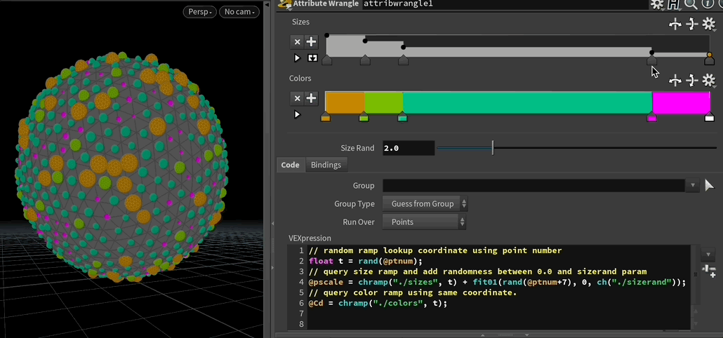

You can add randomness with the rand() function. It generates a number between zero and one. You can use the fit01() function to remap the random number it gives you to an appropriate range and add it to pscale.
To create "buckets" of scales and colors I would use a float and color ramp. The probability is then managed by the ranges in the ramp which gives a nice visual of what the result will be. Since a ramp lookup is from zero to one you can use the rand() function again to generate a random coordinate. The knot positions on the color ramp are connected by expressions to the knots on the sizes ramp so that the two stay in sync. If you add more knots you'll need to sync the new positions.
It's 3 lines of code if you don't include the comments hip file attached.
Edited by antc - March 26, 2022 20:02:21
rampss.hipnc (213.3 KB)
