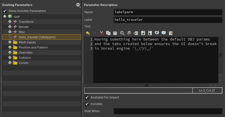

I have experienced this exact problem, and in UE4 as well. I think it is a current bug with the HE plugin.
It seems to occur when you only have Folders at the top level of your HDA, like this:
HOWEVER, having a non-nested parameter above these folders seems to fix the problem, and then it displays fine in the unreal UI. So my current work-around is putting a label param at the top and then making it invisible..
Bit odd but at least an easy fix for now!
Cheers
Joined: Sept. 2021
Worked exactly like you described! thanks very much for the help, greatly appreciated
