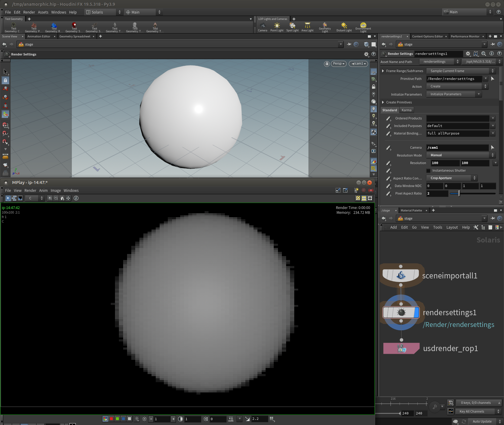

635 posts
Instead of "Adjust Pixel Aspect Ratio", what if you use "Crop Aperture"?
anamorphic.hip (301.5 KB)

I experimented alot and found the solution:
- use "crop aperture" or "adjust aperture height" on the "conform policy" in step 4 in my previous comment instead of "adjust pixel aspect ratio"
robp_sidefx
man I wish I saw your comment earlier, I am glad that there are two options that give the same correct results.
Hope this helps someone in the future.
