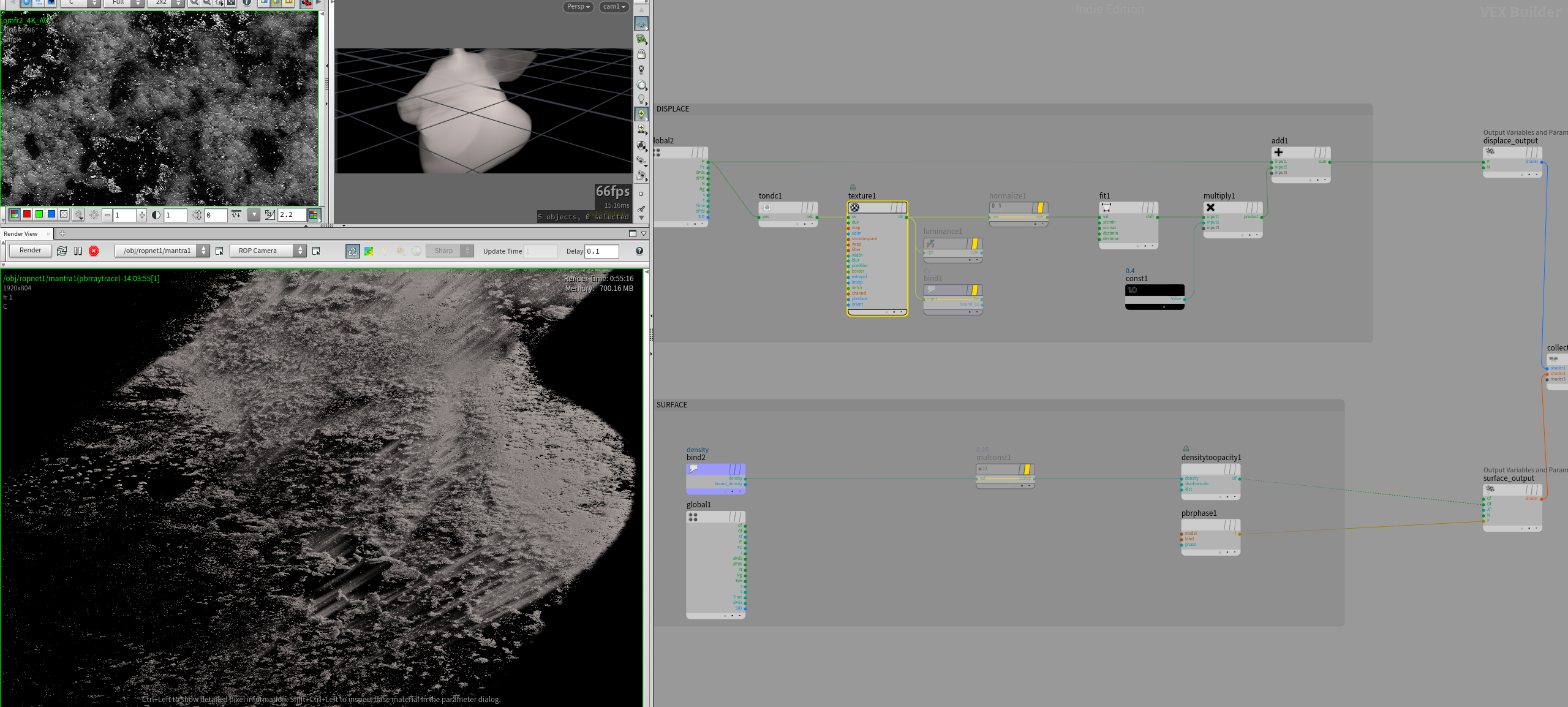

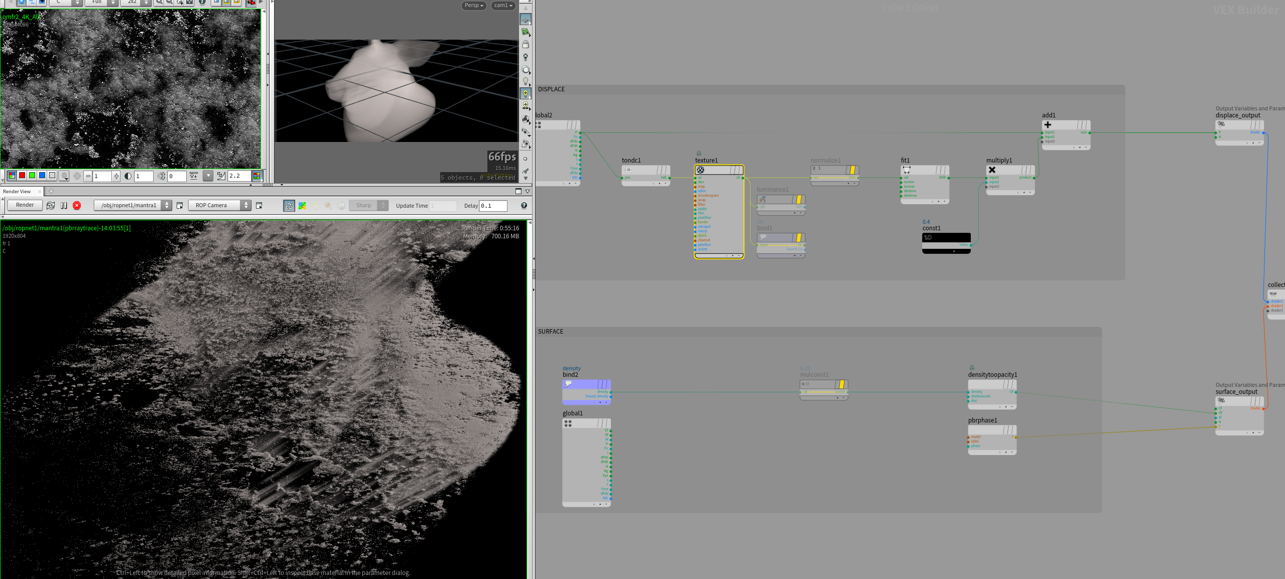

You can always use Mantra, until Karma catches up... no need to use Arnold:
