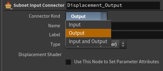

I'm building a MaterialX UDIM Material Creator with Python.
I've been able to make everything work except for this one thing.
I've been able to correctly set "Connector Kind" menu to "Output" through python.
It works as intended with the follwing python code:
randomVariableName.parm("connectorkind").set(1)
When inspecting the "edit parameter interface" up in the right corner I can see that the type is set to "Ordered Menu".
Everything good so far!
However, when I try to access/change the "signature" parameter on a materialX image node, then I run into trouble.
Upon opening the "edit parameter interface" in the top right corner, I see that the type "signature" is set to string.
When trying to change the type "signature" parameter with the same code as stated above, I receive an error message saying I can't use an integer to set a string variable.
I then tried to set it as a string;
RandomVariableName.parm("signature").set("Vector3")
With this, I do not receive any error messages, however, it defaults to being set as "Float". Since this is a normal map
I am trying to set, I require it to be a Vector3.
I've been racking my brain around with for a few days now and have come to a dead end.
I'm quite new to python in houdini & python in general so this might be quite easy for someone else.
Thanks for reading!
