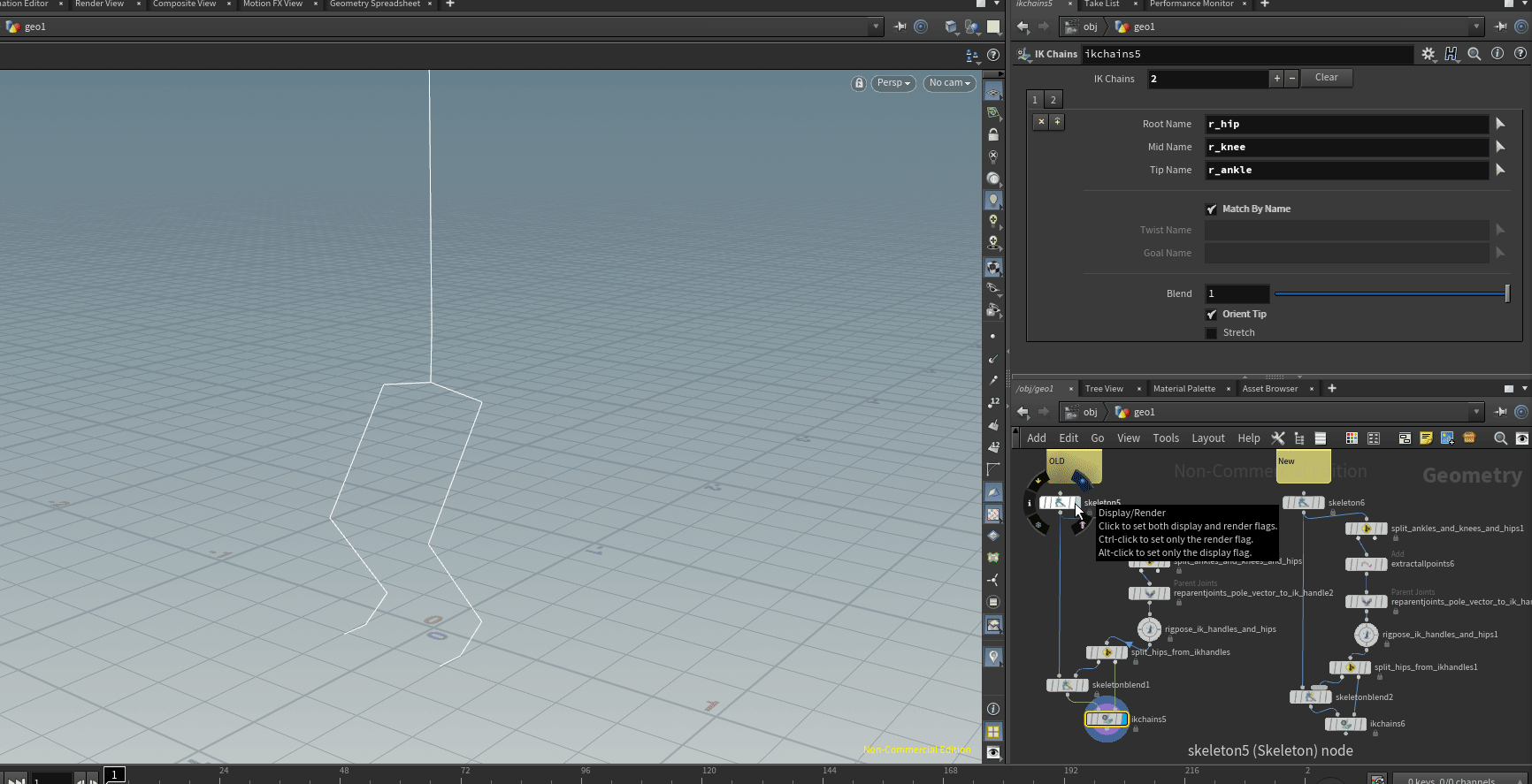

Good Morning,
I was having similar problems following older examples. I ended up experimenting with a file provided by mestela in this post:
Post [www.sidefx.com]
This file still had an old skeltonblend node for me to compare to.
The new node for me made the skeleton warp or collapse. I found the only thing that worked was specifying the group to the specific bones you wanted to blend.
I show what I mean in the attached gif.
I hope this helps,
John

Wow. ThankYOU! I've been stuck on the merge for a month? I tried 3 versions of the furdude tutorial and continually failed at the merge.
I could not get past this part of the FurDude tutorial because the skeleton was collapsing past the skeleton merge.
This appears to have fixed it. All the bones I modified to reblend, I added to the group on the skeleton blend. Seems to have worked for now. Continuing on.
