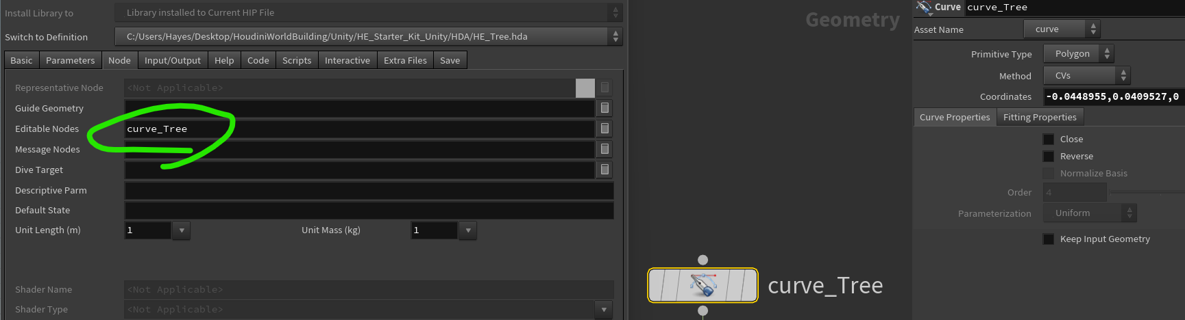

After some fiddling, I can see editable curves (image 1) on assets from the Unity starter kit. https://www.sidefx.com/tutorials/unity-starter-kit/ [www.sidefx.com]
Those assets have the curve node listed in the editable nodes (image 2) and the HDA shows a Curves section with Houdini Engine in Unity which I presume is correlated. For some reason though if I add a curve as an editable node in my own HDA (image 3), I get no Curves section on the HDA in Unity (image 4). What am I missing?

Well, I figured out a workaround. Basically, reverting the curve 2.0 node back to curve like I read on the forums isn't enough. Seems like there are some shenanigans going on behind the scenes. I can only get this to work by copying an old curve node from an old file, in this case, that unity starter kit Tree HDA. Doesn't matter if the settings are the same, a newly created and downgraded curve node won't work. Only an OG curve node will, at least on H19.5.303 unless I'm missing something.

I have the same issue with Unity 2023.1 and H 19.5.
Does it's possible to report that to SideFX ?
Edit:
I downgraded an old Curve node that was from 16.5 and it works again now.
Adding a Curve Node directly from 19.5 doesn't work as it seems to be 2.0 curve node.
Edit:
