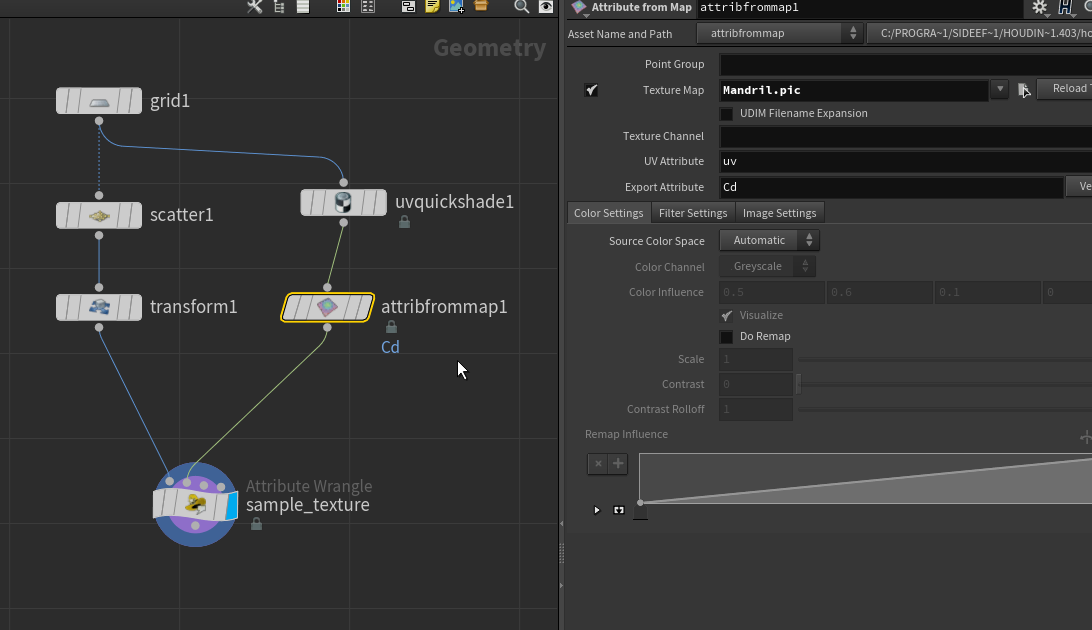

use an "attribute from map" so you can have a Cd attribute from a texture. You do not need the uvquickshade btw
then in the wrangle
int primid;
vector uv;
float dist;
dist = xyzdist(1,@P, primid, uv);
v@Cd = primuv(1,'Cd',primid, uv);

The colormap() function samples images:
https://www.sidefx.com/docs/houdini/vex/functions/colormap.html [www.sidefx.com]
