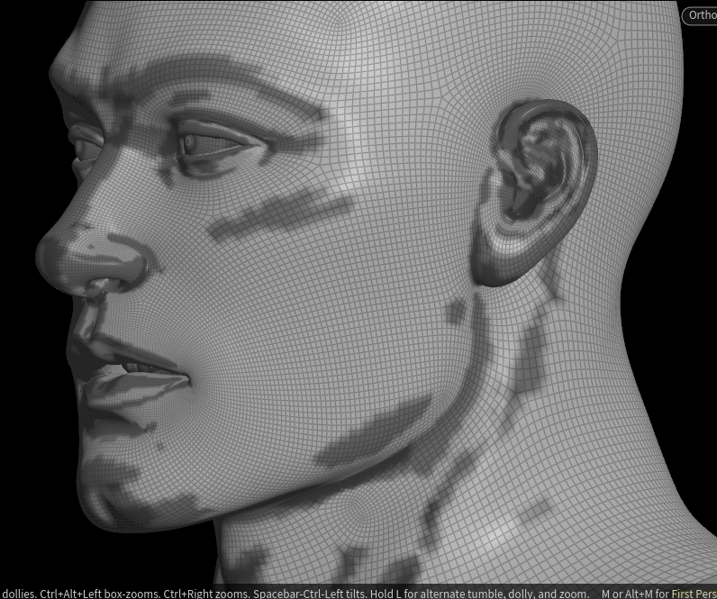

Out of curiosity I went a bit further with the original idea of comparing normals.
However, there is a problem with this, and that is how to mathematically know the difference between if a curvature is convex or concave.
Here's an image to show an example using a simple "a dot b" thing with the neighbor normals. Both the concave and the convex areas are darkened.
Edit: After investigating previous suggestions it seems like using dot product only will not work for distinguishing convex and concave curvature. Min and max curvature need to be calculated from coefficients coming from a matrix (from the point neighbors). This can be used to distinguish between convex and concave curvature. The mathematical steps required for this is advanced. A working solution is (confirmed to be) available according to the early answer from BryanRay.
