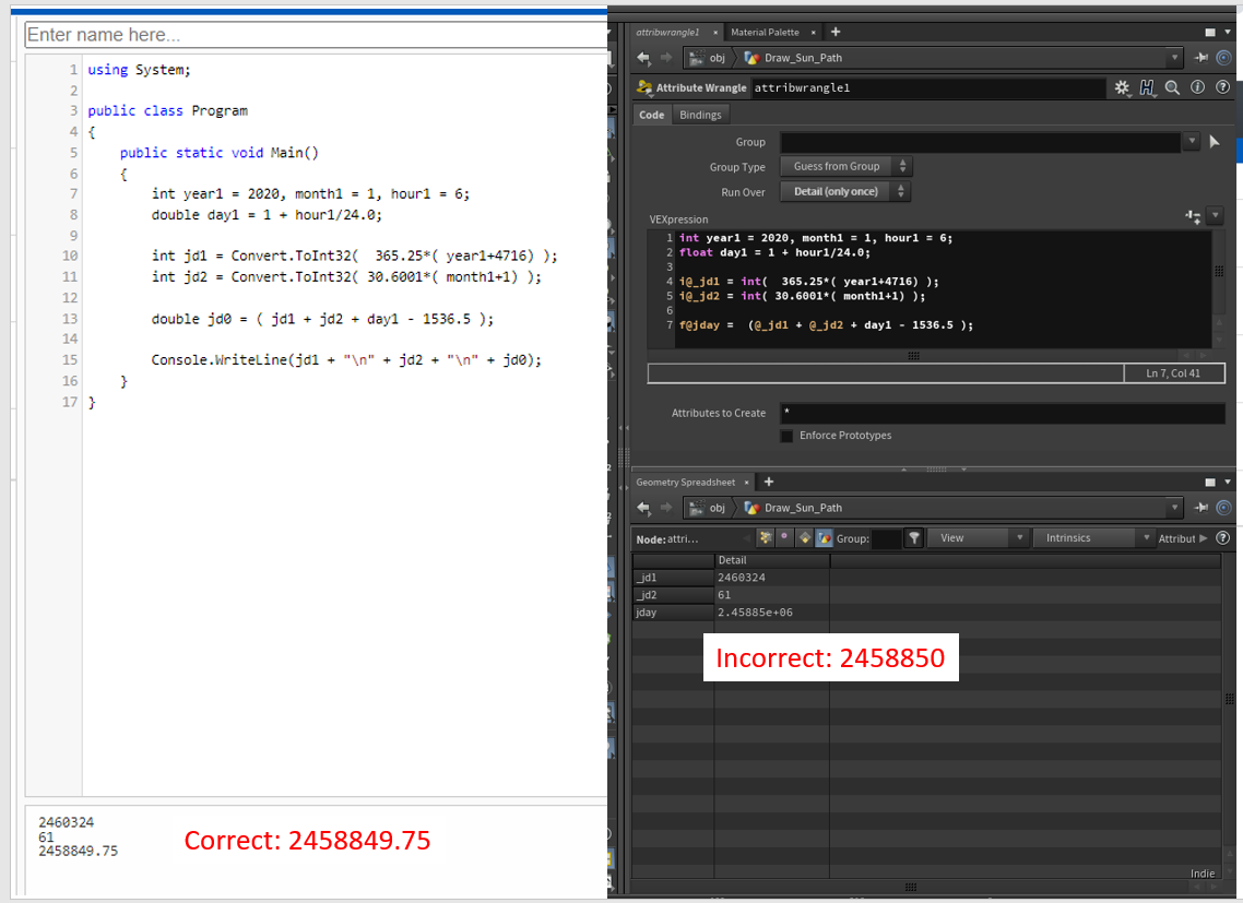

Hi, I'm new to HE
trying to convert Calendar date to Jdate
but since the number is over 7 digits,
I can't get the correct results via VEX like coding in other language,
so How can I create a double value via scripting in Houdini?
or is there a node to handle double attribute in obj Network?
Thanks in advance :[

first thing you need to do is make sure your Spreadsheet is showing full precision (View/Full Precision)
and then you should see the correct answer (instead of rounded number) even with default 32bit single precision float
then if you still need your floats to be double precision, set Bindings/VEX Precision to 64 bit

Hi, thanks for your help,
the website is a good learning source for a newbie like me
I changed the VEX Precision to 64-bit and now it works :]
Hi, thank you for the reply
I haven't noticed I can tweak the settings in Spreadsheet views,
thanks it really help.
