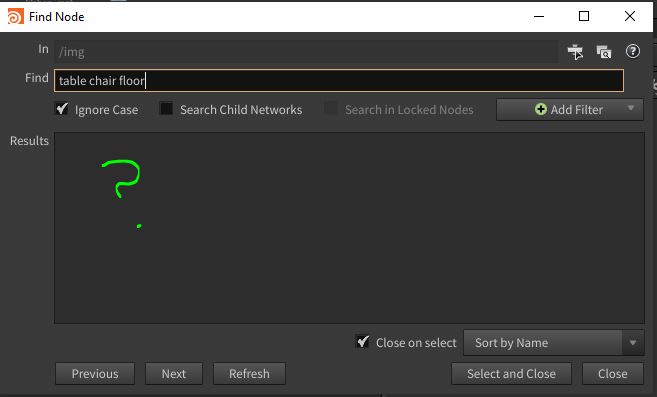

If I have many geo nodes and I want to find a few specific ones. I'm trying to use the Find Node window but I don't get how I can add multiple names in one search.
Let's say I want to get the geo nodes named "Table", "Chair", and "Floor". What do I use in the search field? I tried separating each word with: , & + etc. Nothing works.
Any clue?
-Olivier

try
table | chair | floor
since you want OR not AND

It's good but if I'm looking for table and my scene has table and table01, this will pick both instead of only table.
is there a way to not find any variations of the words?

AH! Found it!
I need to use quotes so I would search like this:
"table" | "chair" | "floor"
