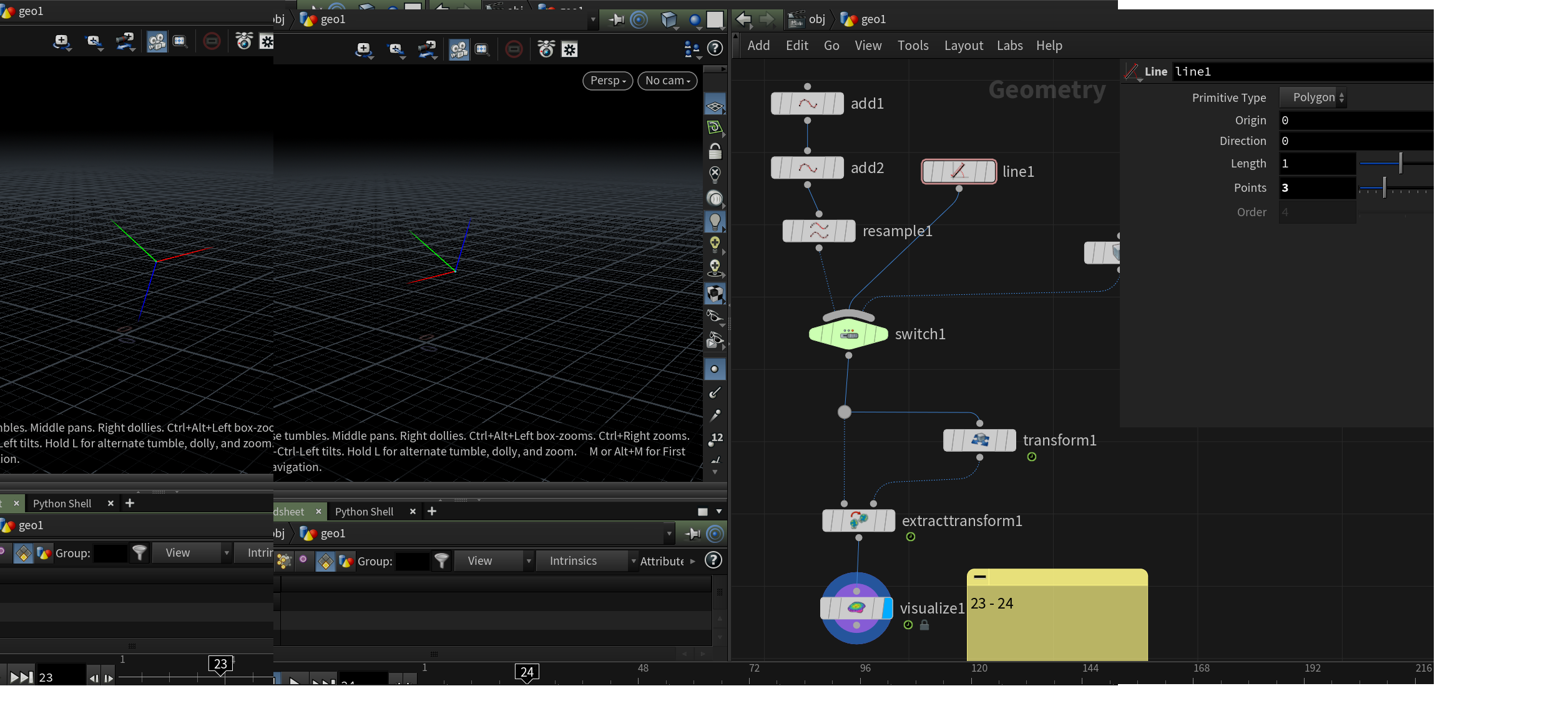

extracttransform node work on line , the orient is jitter

your geo is a line, you can;'t get stable orient from comparing 2 lines, you need at least 3 points that don't lie on the same line
the's the flie and picture; and when ptnums is 7 ,it's also append

As tamte said a line is not enough to define a unique transformation. If all you have is a line, you can try using an up vector to create a stable transformation.
