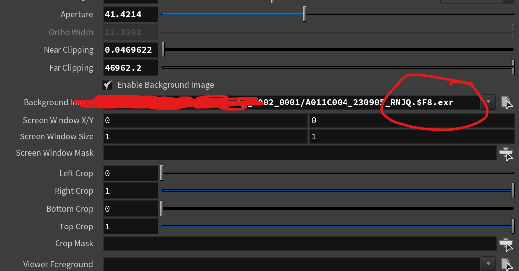

While the new options for camera background images are welcome, the background image does not seem to support numbered sequences.
The frame number variable ($F8) always defaults to the current frame and removes the variable in the display settings dialogue.
This is an oversight, isn't it? Instead of making the sequences load into 128 gig RAM, not my GPU's 12 gig Vram, which I prefer to use for rendering, I now have to add yet another step to the workflow, having to convert all my sequences to video first.
I hope this gets fixed soon. And thought through.

I'm not sure if I understand what the issue is here. I just tried with an EXR sequence and it worked fine after I changed the 000.exr to $F3.exr. Are you saying that the images are not updating in the viewport, or are you saying that the controls in the Video pane are disabled?
Just as a reminder, you'll usually get a much faster response if you submit a bug with support.
OneBigTreeThis has been fixed in Houdini 20.0.528.
The image does not update in the viewer when an image sequence is used on the camera background image (which is the only way to set the background image when looking through a camera as the option is disabled in the display settings). The value of $F is expanded the on first evaluation instead of filling the value with the raw string containing $F.

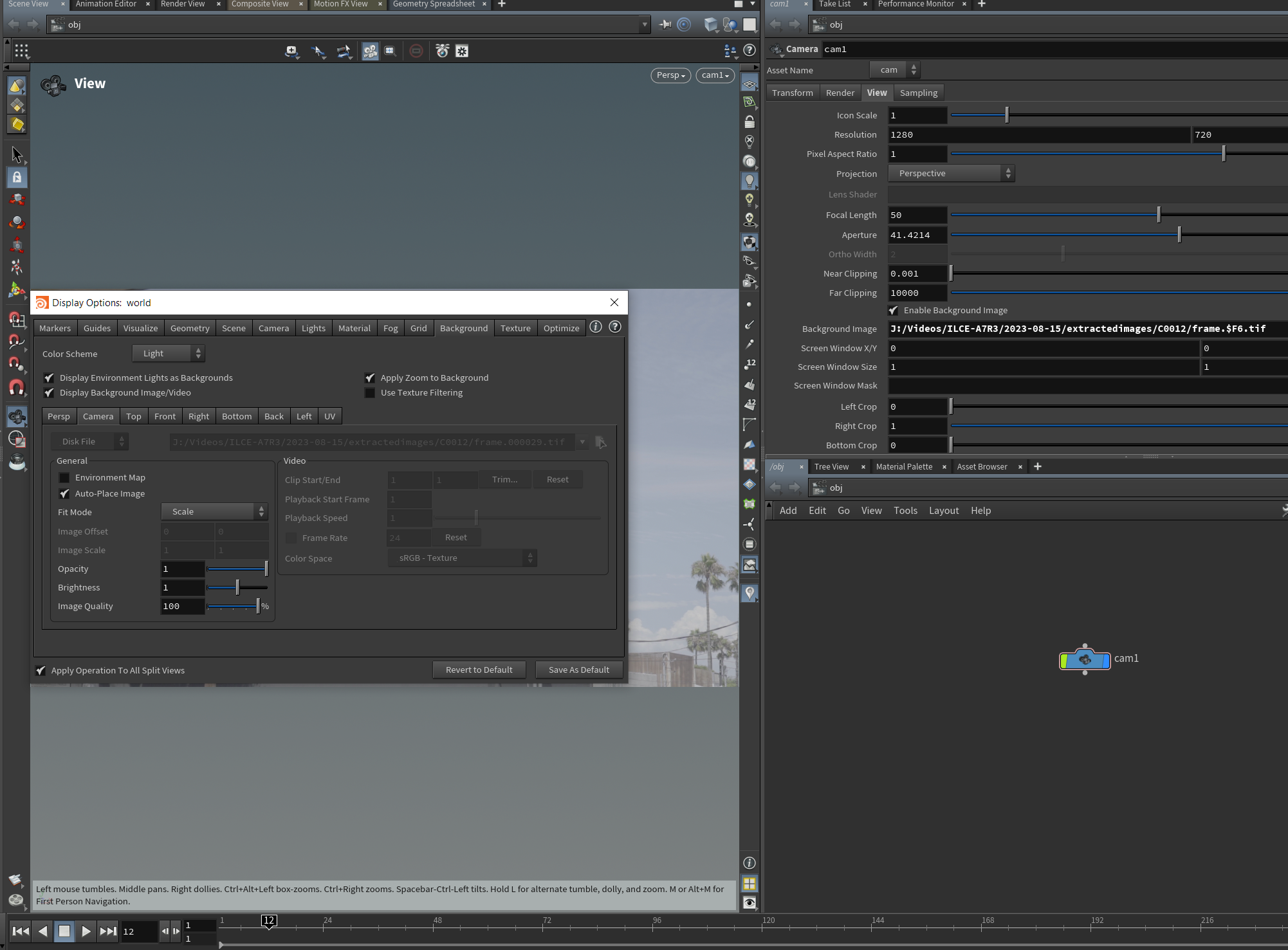

On sequence setup on camera background, if I have display options 'on' and set to 'show background image', the sequence $F from camera bg is replaces with current frame. Also, HI is replacing $HIP path with the evaluated one.
Ex: in the attachment, I set the camera bg on frame 68.
No matter file extension.
