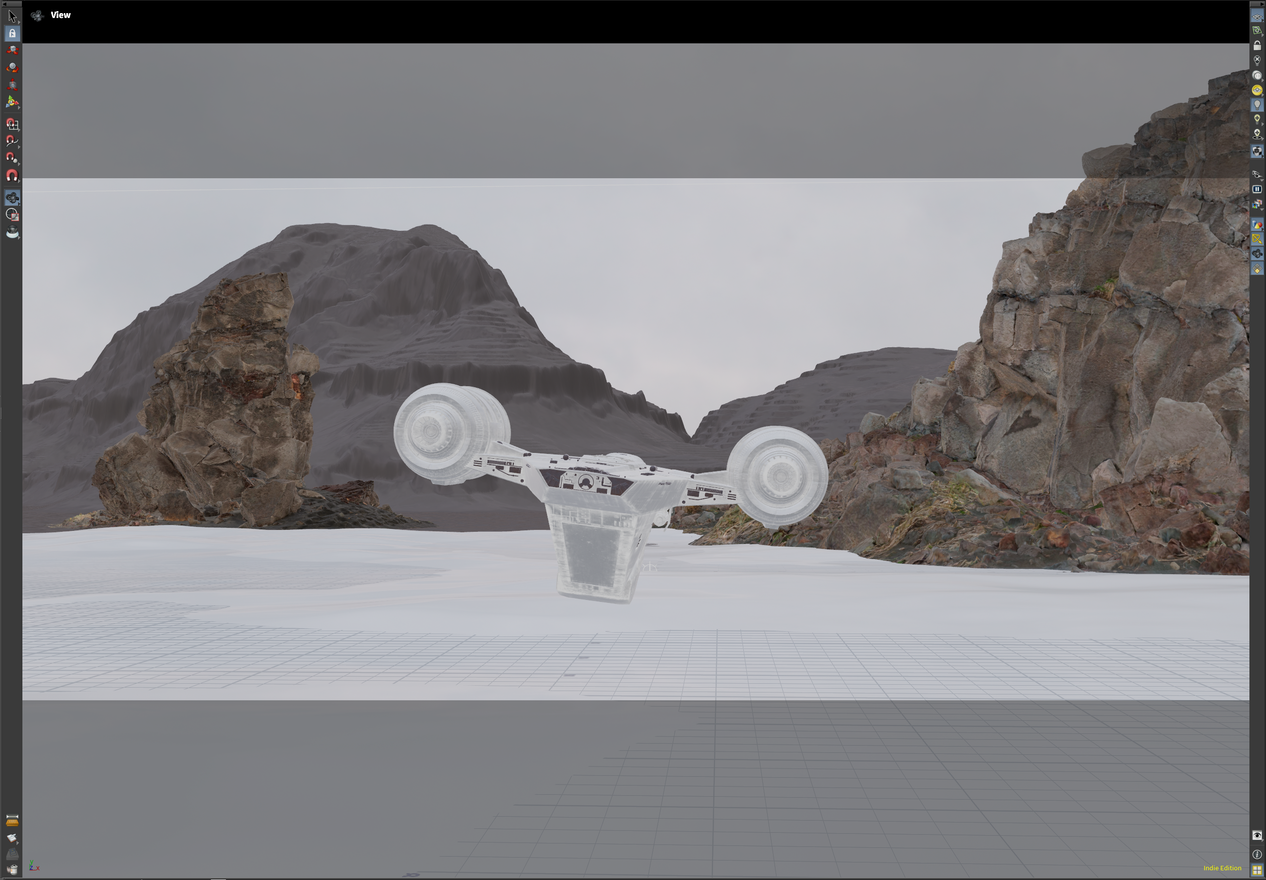

Hey All,
Attached is a screenshot from Solaris 20.0.547. There is a thick black bar at the top of the viewport... which makes it difficult to select cameras, and Hydra Delegates.
This "bug" has shown up since 20.0.506, and it appears in both Windows 11 and Linux Mint 21.2. So it doesn't look like it is a driver issue. I am on the latest Nvidia drivers for both OSes. Should I submit a bug report? This happens randomly BTW... It happens with all project files. I can restart Houdini, and sometime it behaves as expected. Ideas?

Hello, I notice same thing.
On my side, in viewport, if I hit "S" to go in select mode,black bar disappear.

Same issue here, happens from time to time. To get rid of it I just ESC the cam state and come back in.

Did this bug ever get fixed? I'm still seeing this in Houdini 21.0.762 ?
It is only a problem with the OpenGL version of the viewport Houdini_VK works fine it seems..
