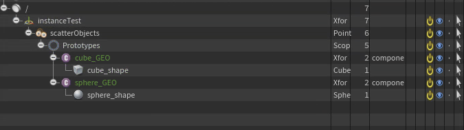

I've attached two images to show what I mean - when creating in SOPs, it always wants to add the name attribute as a parent prim on top of my prototype's geometry path. Even if there's no name attribute, it just generates a generic obj_0 named prim as the parent. The LOP instancer seems to just not have to do this (I guess since it's not doing the same "attribute from pieces" workflow to scatter the different prototypes around?)

I can't get it to create the prototypes in the scene graph in the same way that the LOPs instancer does ... it always wants to add the name attribute as a parent prim on top of my prototype's geometry path
The parent USD prim is the packed SOP "bucket of stuff". You're right that in your cube-or-sphere case it's unnecessary, but in other cases (for example if you're packing-and-instancing a cube-AND-sphere), then you need a USD prim to represent the aggregation. This would be true regardless whether you were using SOP Import or the Instancer LOP.

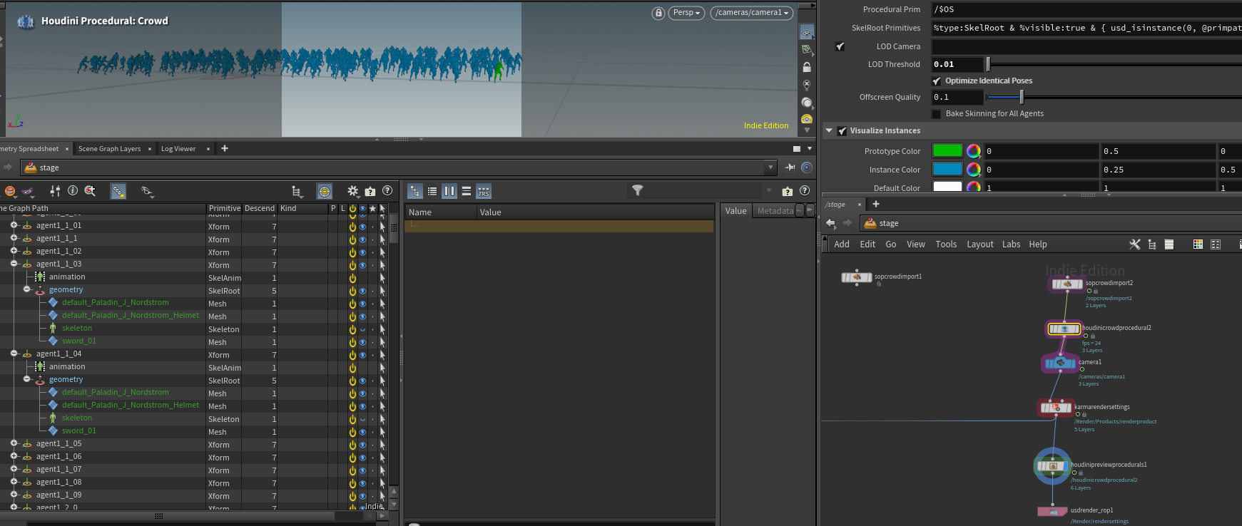

I'm Using the crowd Import sop and crowd procedural nodes, but I thought something was wrong, because the color of the instances was gray, and usually usdskel instances are blue in the graph, also I'm new to solaris but the speed of my crowds isn't as fast as sops idk if this is normal?
Edited by Cgstuff - June 17, 2025 07:09:59

If it's the "Visualize Instances" option on the crowd procedural you're referring to, then that would mean that none of the SkelRoot's will be instancing the same deformed geometry (there are also some stats about this in the render log, if verbose logging is enabled)
You could try adjusting the tolerance parameter to see what effect it has

thanks cwhite this is definitely faster but is there a way to make it as fast as sop during viewport playback in solaris? also notice that the agents are gray but the geometry is blue even thought in it's supposed to be instanced USDskel, maybe it is and in the new version it doesn't show the legend as blue?
Edited by Cgstuff - June 18, 2025 03:06:19

If it's the scene graph details pane you're referring to, that's expected because each agent has its own unique `SkelAnimation` prim (which describes its pose), while the 'geometry' child prim is instanced since it contains the rest geometry that's shared between the agents
The viewport playback is not currently expected to be as fast as the SOP viewport, due to the lack of instanced GPU skinning when rendering through Hydra that I mentioned in the other comment.
