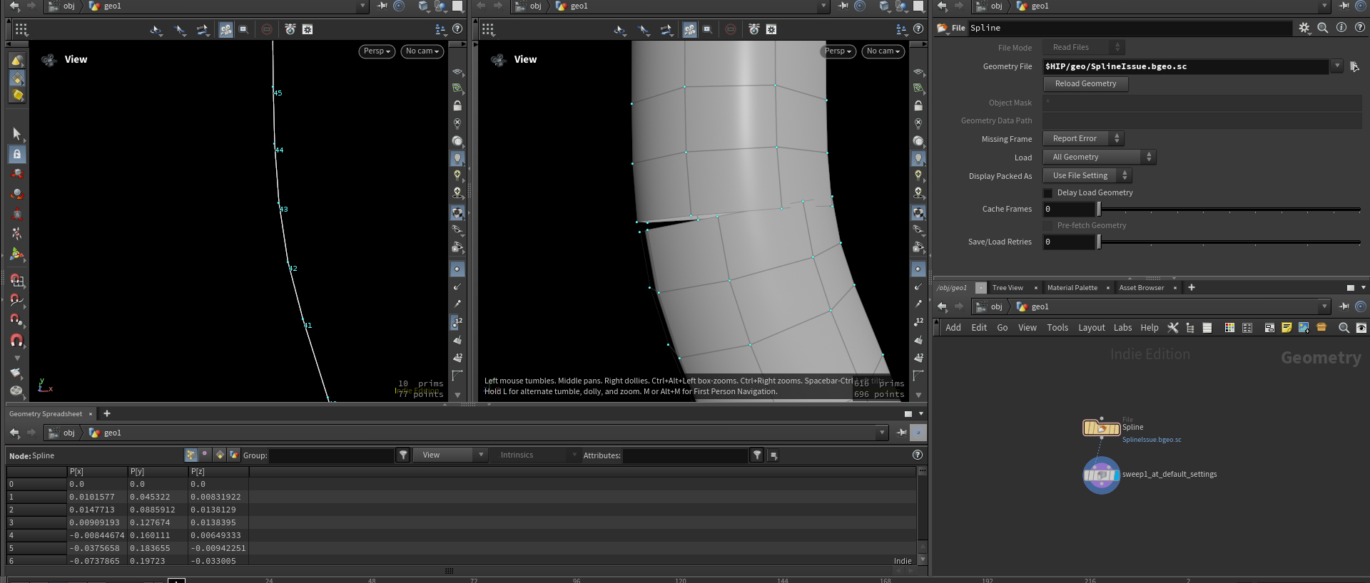

Hello, I've got a problem with a spline/curve in Houdini.
I want to take a curve and run it through a sweep node but everytime it has a break in it, I think it has something to do with the direction the points are facing, because when the sweep is run and geometry added you can clearly see a rotational difference between the top section and the bottom section. (as the curve was made from two separate curves originally)
I deleted all attributes and groups to isolate the issue, the only thing on the geometry spreadsheet are the point positions and I made sure the whole curve is one whole piece.
I attached the hip file for you to inspect.
Any help would be appreciated.

It's still two curves. Prepend a polypath or fuse and join (set to 'only connected') nodes before sweeping.

@Konstantin & @recomberlin Thanks for having a look.
I had previously fused the curve, so I didnt realise another operation was required to make sure a curve was one complete object so thanks for pointing that out.
I did what you said and that fixed the part I showed in the image, however the top parts are still disconnected even when I append a polypath or join.
