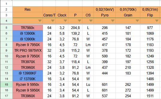

But I've seen a handful of speed performance graphs where intel wins in single and multi core jobs. A comment on vfxArabia attached below has this Houdini benchmark showcasing some stats where last years intel is beating out the current 7950x.

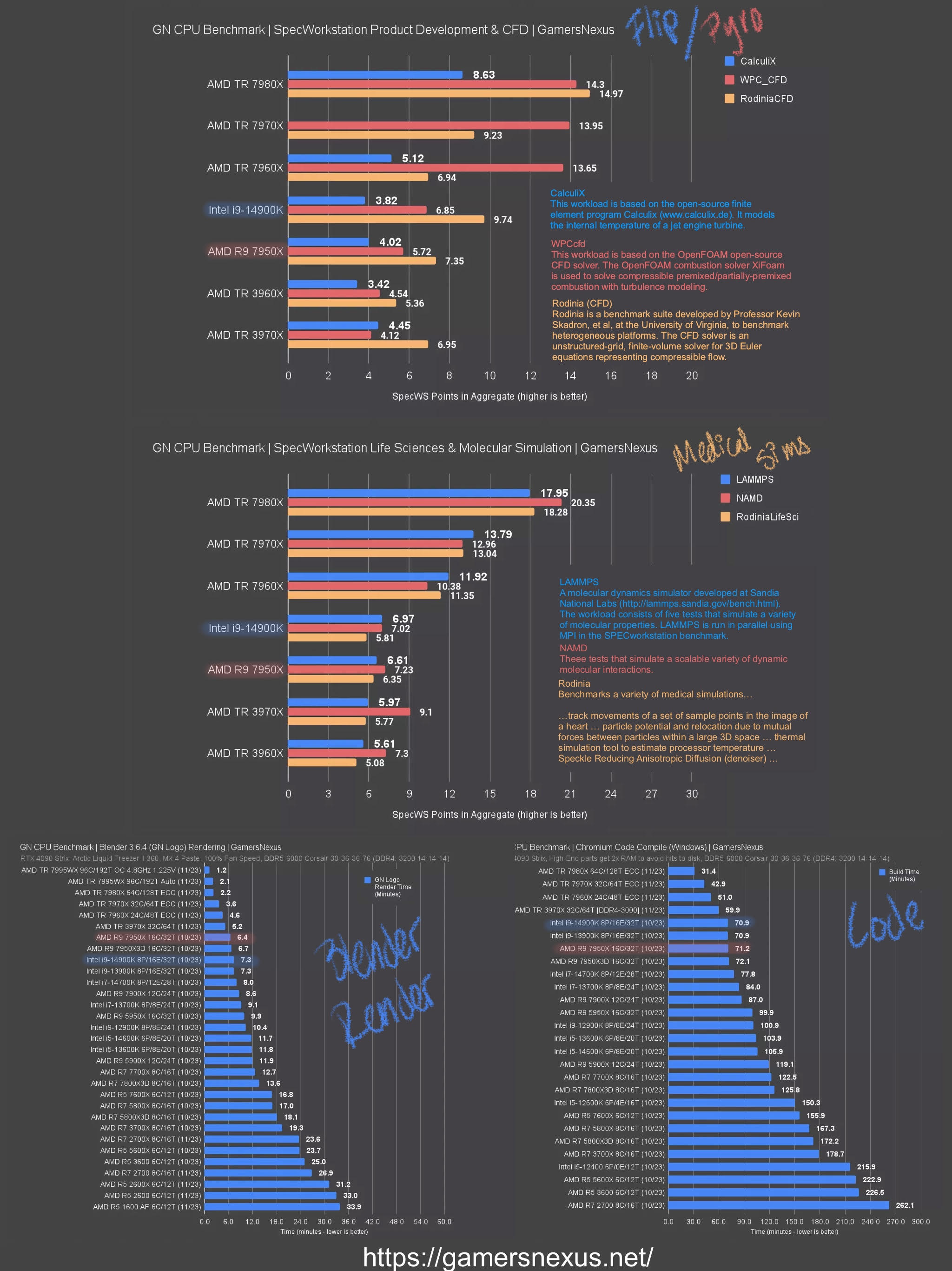

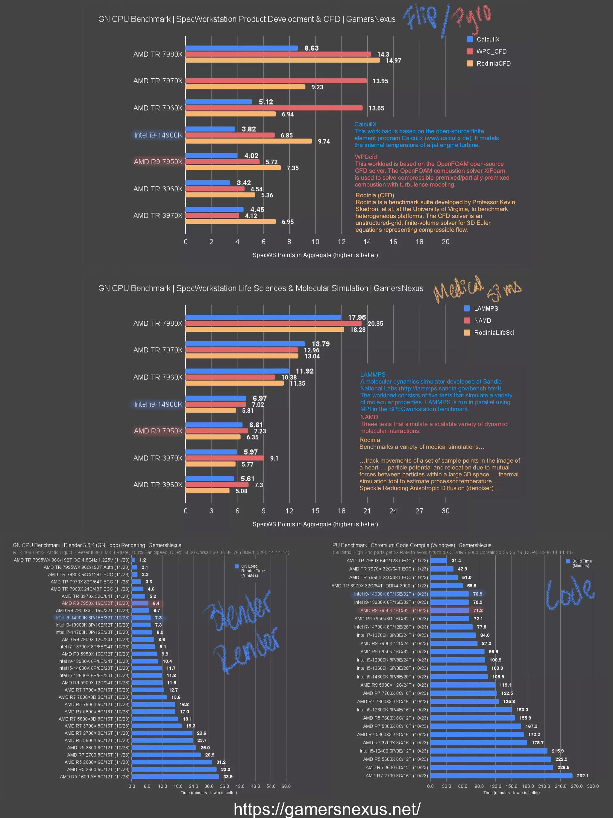

I did some more digging and I put together these graphics i found on gamersnexus [gamersnexus.net] that compares the threadrippers, i9-14900k, and 9 7950x... They dont benchmark houdini specifically, but based on the results found from other simulation benchmarks it looks like the Intel CPU might actually be better?
