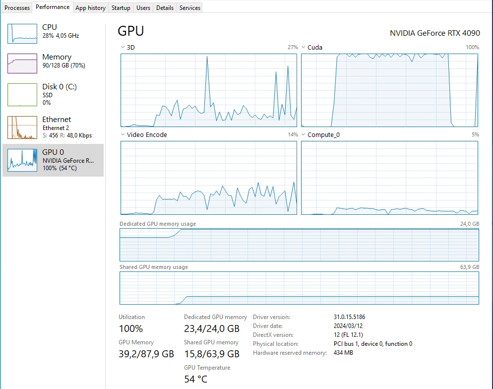

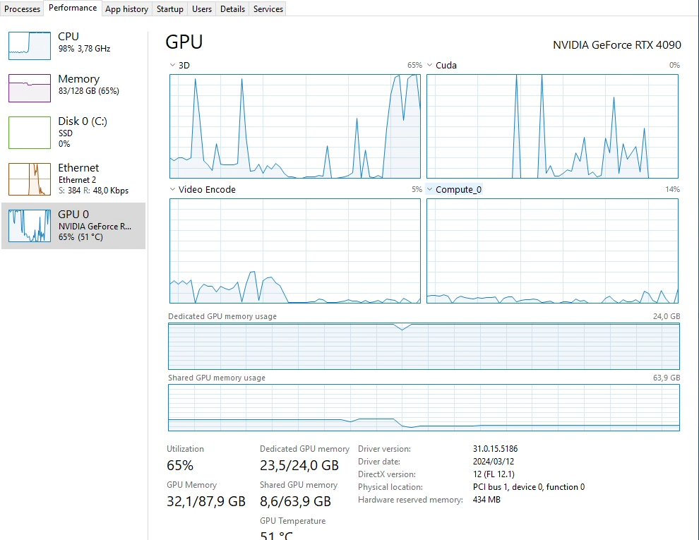

I definitely wasn't expecting slower render times with a 4090 involved. I logged into the machine to check what was happening while the job was running. It does try to load some GPU memory but for a few frames never fully uses the CUDA cores or the GPU to render it seems.
Here is one frame that was using the CUDA cores for a bit, but memory usage is very high. So maybe wasn't getting everything into memory that it needs to render at max efficiency.

We actually see the first and 4th frame using the GPU more than the CPU, which outputs the kind of render time we're expecting to see. However subsequent frames are much longer again. Most frequently averaging as mentioned above.
So possibly slowing down when GPU VRAM is overloaded? Or something else?

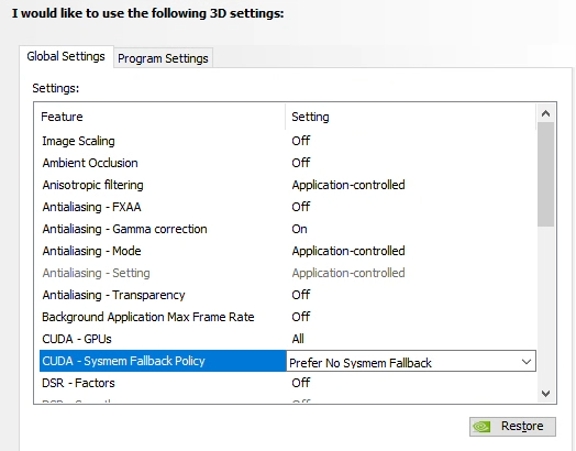

There is a new Windows/NVidia feature where Optix/CUDA GPU memory can "spill" over to the CPU ram when the GPU gets full.
https://nvidia.custhelp.com/app/answers/detail/a_id/5490/~/system-memory-fallback-for-stable-diffusion [nvidia.custhelp.com]
This is still a very new feature and we're having trouble getting information about it. But I can see your machine is doing this because the "Shared GPU memory" is at 18gig. What happens if you set "CUDA system fallback policy" to "Prefer No Sysmem fallback" in the NVidia control panel? (which will disable this feature)

Are you able to watch the task-manager stats during a render where the GPU fails. And perhaps take a screenshot. I want to see what happens at the point of failure. We should be releasing GPU (and also the "Shared GPU memory") resources once it fails, but perhaps we are not.

2) Interesting, good to know. With that setting enabled, the GPU appears to fail to load much/keep VRAM loaded and then appears to just render purely on the CPU.
3)Attached 4 images, trying to capture some of what the GPU is doing during and after the frame is completed.
As a point of failure, only really noted that about 25% into the frame rendering the CUDA cores stopped reporting utilization, however the GPU would still list itself at 100% sometimes.
(ps. this was a mostly stripped down scene, but the memory usage is still high)
What render time did you get when using that NVidia driver setting?
Did it go back to being as fast as CPU-only again?
I'm wondering if its the NVidia driver memory swapping stuff that is slowing down your scene with GPU+CPU vs CPU-only
am_wilkins
Yea... we've found the Windows "GPU-utilization" metrics UI to be very incorrect for NVidia/Optix :/
For example, when rendering with two GPUs, the 2nd GPU often registers as not having any load, even though its working full-steam.
Does that show the stats after the GPU has failed, but while the CPU is still rendering the frame? Or has the whole frame finished at this stage (eg husk/karma has finished and closed). The thing I'm trying to determine is if the GPU releases all its memory at the point of failure, or if it only happens at the end of the frame.
Thanks

brians
Yes, back to the same speed as CPU-only again. ie. that +-4min frame time from the first post.
