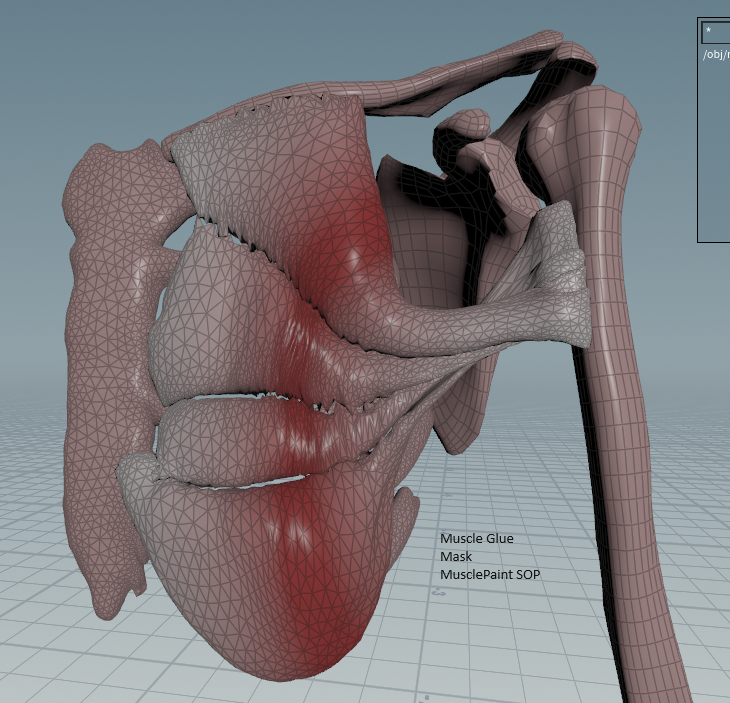

When I use the Muscle To Muscle constraints. The Muscle attachments cause spikes in the muscle geo like every other vertex is being pulled. I've found Muscle Glue Mask yields a cleaner result I'll attach some pics as well
With weaker material properties and low substeps, MuscleToMuscle will potentially pull points into spikes. Internally, MuscleToMuscle uses Vellum Stitch, and MuscleGlue uses Vellum Glue. (The difference being one uses a point-to-prim attachment, and the latter uses a one point to multiple other points attachment -with no sliding).
