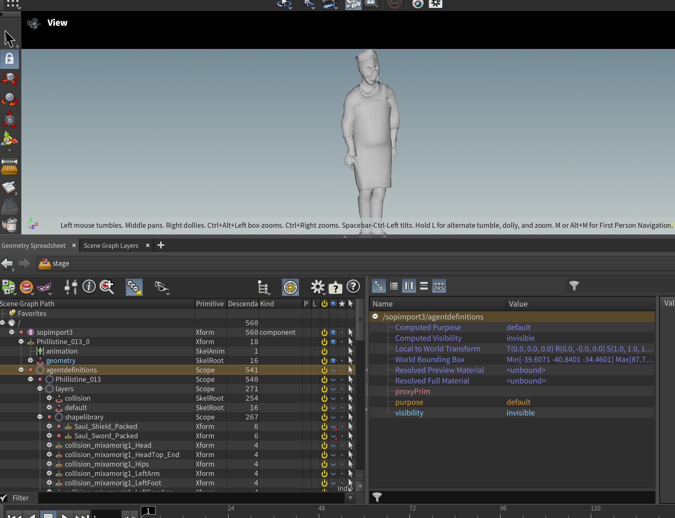

I am building a crowd system of an invading army. I have a number of agent using the mixamo rig and I've created two props for them: a sword and a shield. It's all going swimmingly until I bring them into Solaris. Then the props don't show up even though they are in the scene graph. I suspect it's either how I've put the crowd together (I'm coming up to speed with the new agentLayer node) or it's due to my noob level knowledge of USD. Either way any help would be appreciated.

Your display is overridden for those prims (the red dots mean they've been overridden, the closed eye means they're hidden). Click on these icons and they will show up again. You'd then need to put down a Configure Primitive LOP and change the visibility to get that setting to stick.
