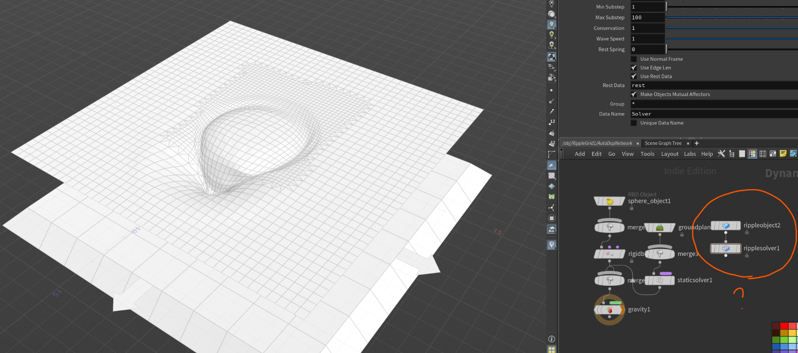

For example, the document says:
The orange flag marks the “output” or “endpoint” node of the network: only nodes above and including the node with the Output flag will be part of the simulation. There can only be one node with an active Output flag per network.
However, this works:
This is the official example of Ripple Solver. But the document just clearly states only the nodes connected to output node will be processed. Then why this ripple simulation works when Ripple Solver isn't connected to the output node? Why doesn't it need to be merged in?
EDIT: Well these two nodes don't actually work at all. The "real" ripple solver is in another network. So yeah the document is correct. Not sure why the official example has these two nodes that do nothing.
