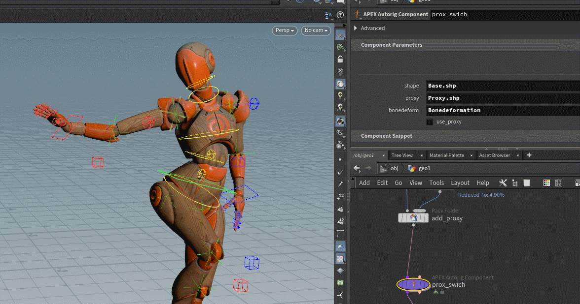

Another thing you can do, is to only add the proxy mesh to the Base.shp folder while you are animating. When you are done you can add the hi rez to the Base.shp
164 posts
Joined: Oct. 2023
here is a simple example of how you can add the proxy mesh and then change the graph to read in the proxy instead of the base mesh
proxy_switch.hip (293.5 KB)

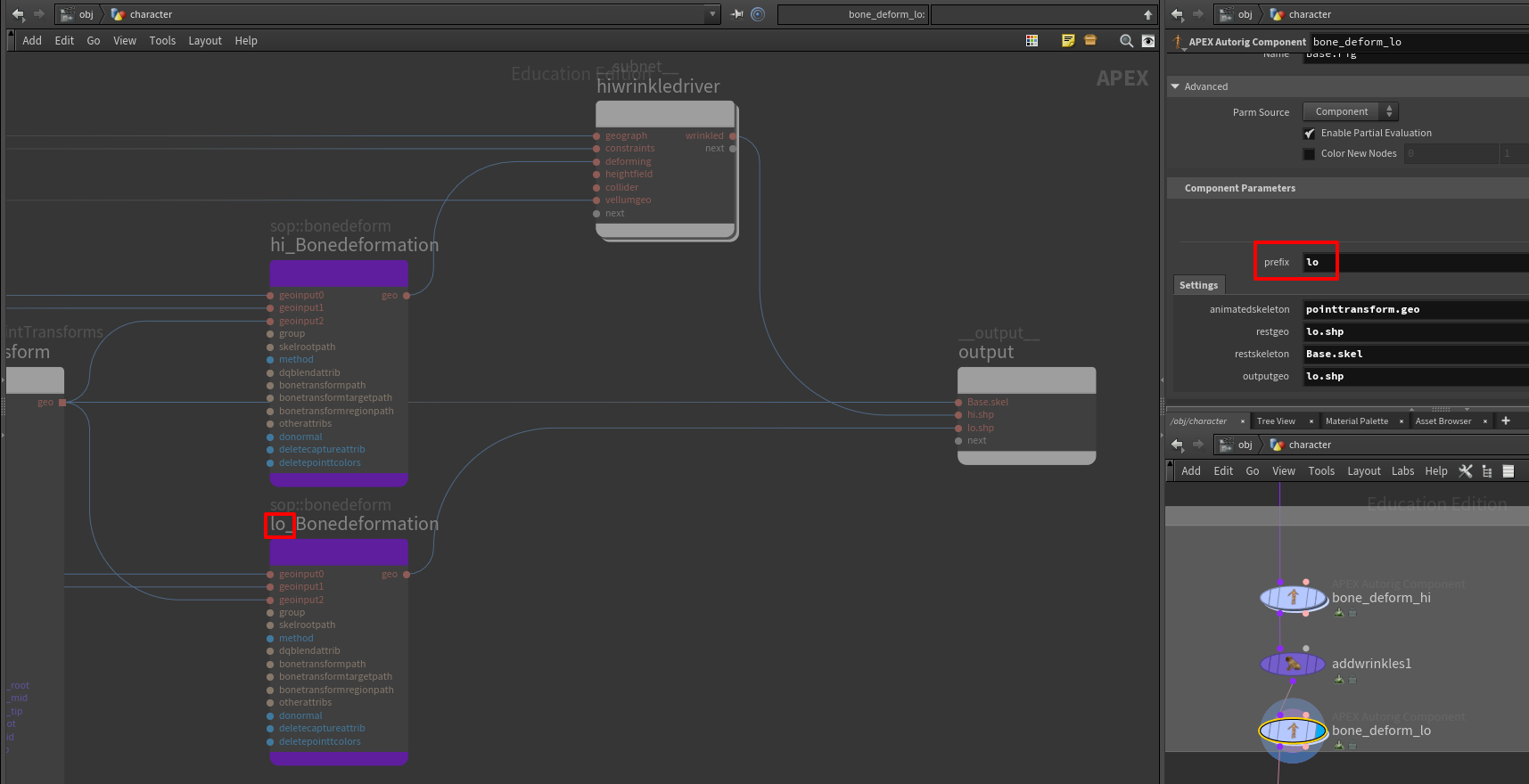

I successfully solved part of my problem by adding a prefix to the bonedeformcomponents. This way, the two nodes are independant in the APEX graph. I had to move the wrinkle component after the first bonedeform for everything to work properly.
The only thing that is missing now would be for the Scene Animate node to allow hiding shapes we don't want to see/evaluate.
I can export the hi and the lo of each character independently, but looking at the time it takes to export both, it looks like Houdini is evaluating the whole graph. I was expecting it to be much quicker when exporting the lo since it doens, have the wrinkle node. Of course, the Scene Animate node is slow to interact with for the same reasons. I hope we can hide some shapes directly from within the Scene animate node in the future so animators can choose what to see while working without having to leave the node. But Houdini will have to be smarter and evaluate juste the parts of the graph that are needed then.
I tested the proxy switch solution and figured that I could change the bool parm for an int. This way I can use more than just two resolutions. This could be useful for muscles and such. I don't quite like the fact that I need to go back up the grah and change the switch after each export but it is a workaround I can live with. I will explore solutions around it in more detail.
