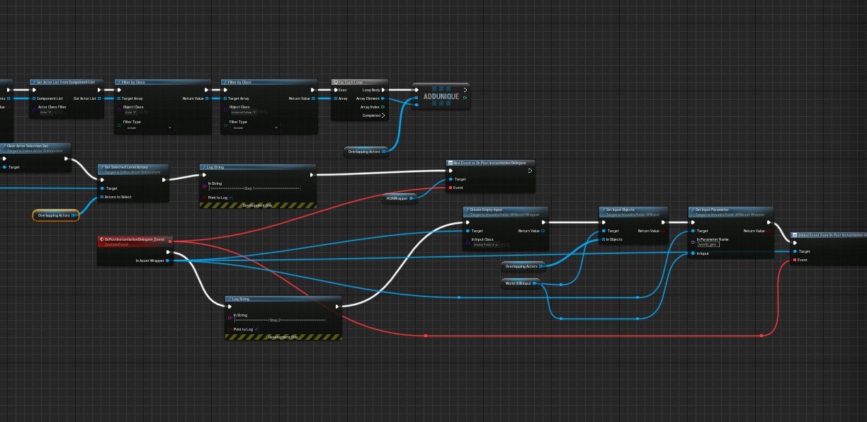

Thank you for your help. I had another question if you don't mind? Basically I'm promoting an object merge as an input for my HDA and the set input doesn't seem to work. Either that or the "bind event on post instantiation" doesn't seem to be getting called for some reason. I did a print log and my step one prints but the step 2 for the bind event does not print not sure what I am doing wrong. Or if I am setting the input correctly for the object merge param on my HDA?

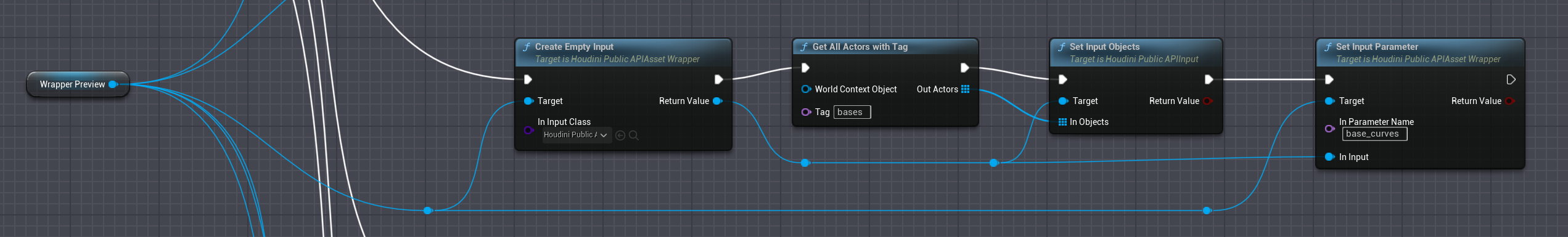

No worries. Looks like you need to take the (Return Value) from the `Create Empty Input` node, and feed that into your (Target) for the `Set Inputs Object` & (In Input) on `Set Input Parameter` nodes. Both are coming from some other variable, it's a bit blurry to read. But I think if you swap those around, it should work fine.
Here is an example I have working with world inputs on an Object Merge parameter. This grabs everything in my level with that tag, and adds it to my input.

still doesn't seem to work for me
Hopefully this is a better image

If anyone bumps into this, you have to check your event delegate to work in editor in the details panel.
