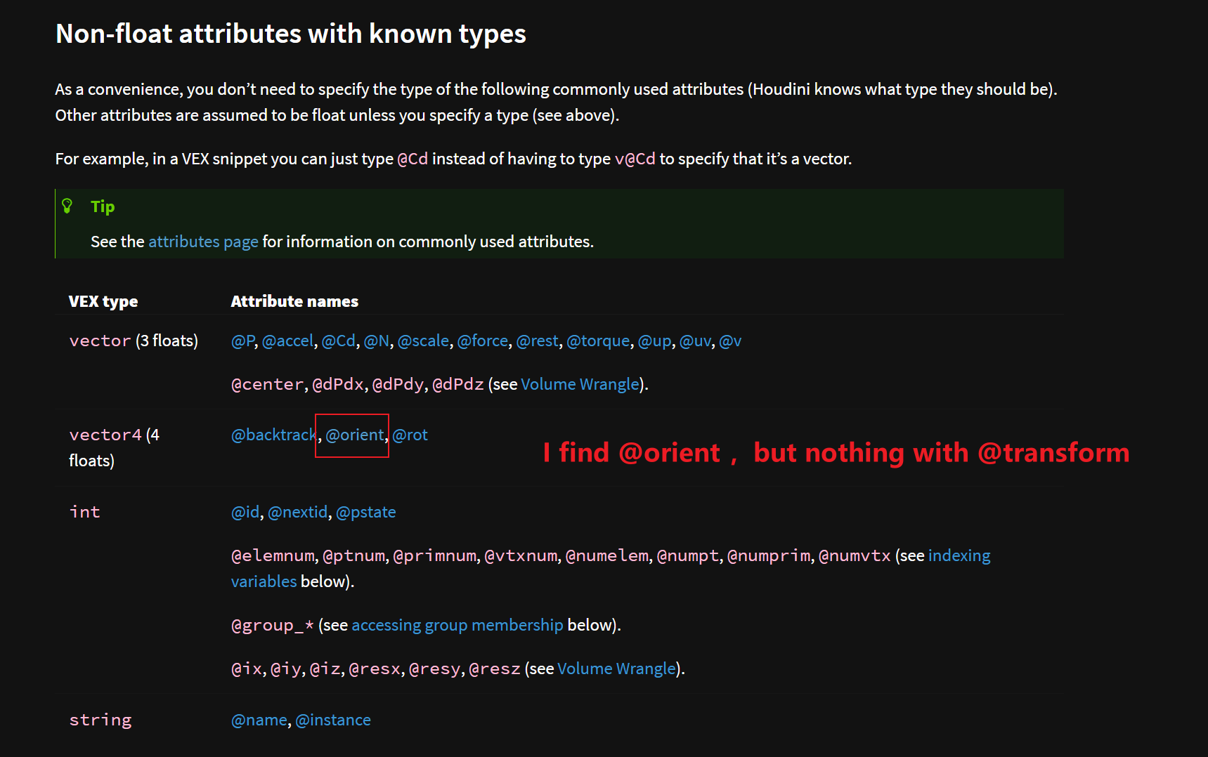

In my case,
Instead of p@orient, I can combine Copytopoint nodes and adjust the rotation value with 3@transform.
But I'm a little confused that I find nothing with 3@transform in official manual,
Is it an attribute defined as a houdini known type?
matrix3 m = ident();
rotate(m, radians(chf("angel")), set(0,1,0));
3@transform = m;
//p@orient = quaternion(m);
I find @orient ,but nothing with @transform.png (148.3 KB)

Hello,
3 is not a vector type. You use 3@transform to write a 3x3 matrix (aka rotation matrix) which is called "transform". The rotation matrix called transform is a standard and can be interpreted by the copytopoints SOP in the same way as orient, or N or v etc.
There is also 4@ and 2@.
It's listed here, it can be 3x3 or 4x4 matrix
https://www.sidefx.com/docs/houdini/copy/instanceattrs#attributes [www.sidefx.com]

Dear Xue_Yue , thanks for your detailed explanation~!
24 posts
Joined: Aug. 2023
tamte
Hi, dear tamte, thanks so much for the url,
oooooh, that's it~!
