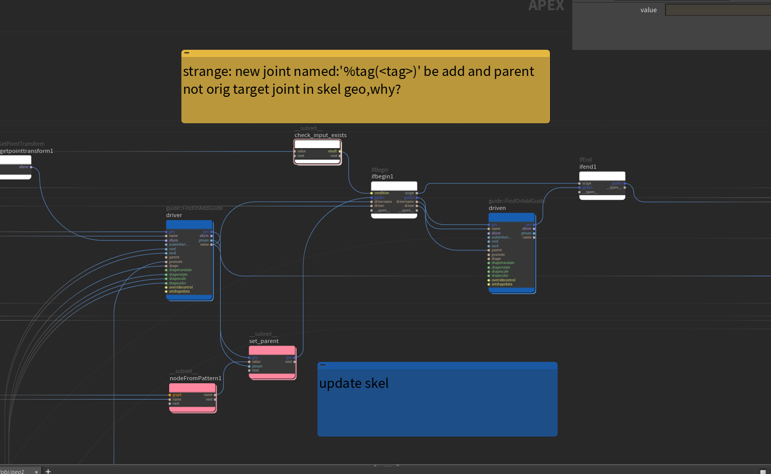

some more question:
autorigcomponent -> transformdriver:
we use tag-pattern-func in the driven parm, component will add a joint named with this tag,e.g:'%tag(Pelvis)',and parent this new joint ,why not parent the true taget joint in orig skel? What are the benefits?

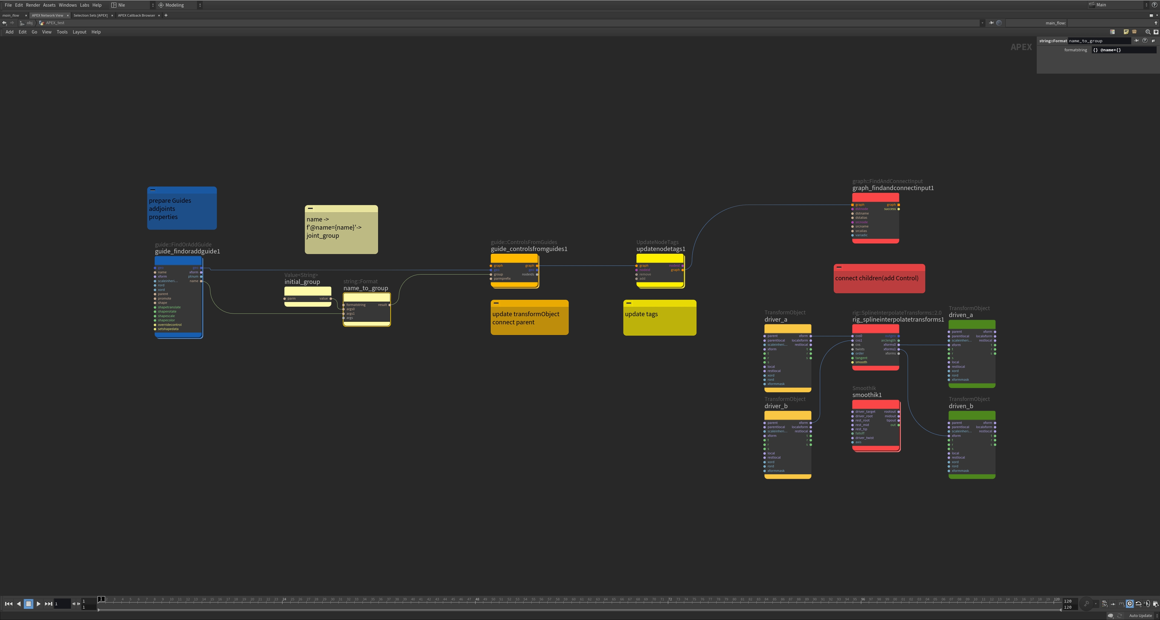

Joined: April 2021
Recently, I’ve been looking into some built-in component graphs and wondering if my current understanding is roughly correct.
I hope to establish a relatively clear approach to learning how to build graph workflows.
While the process can be optimized and modified, having a baseline to start with is essential.
When the graph becomes too complex, it’s easy to lose focus or overlook critical operations.
Its flexibility makes it feel like some level of structure or constraint is needed to help with understanding and getting started.
It's great to get some advice about apexgraph work flow ,THX~~
8171 posts
Some of this is very much in progress as we indeed are building higher-level components for the next major release.
- I'm not sure about your node named "%tag()" issue. I suspect it might due to using %tag() in a place that only expects a name, not a pattern.
- When the graph becomes too complex, APEX Script is the way we envision things going. This allows one to scale up to production rigs.
There are starting to be some tutorials in the mean that you can check out if you haven't already. Go to https://www.sidefx.com/tutorials/ [www.sidefx.com] and type in "apex" as the search term. For example, someone made an APEX Script tutorial:
- https://www.sidefx.com/tutorials/effective-apex-scripting/ [www.sidefx.com]

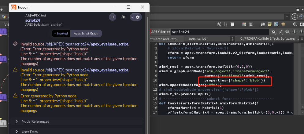

Joined: April 2021
I have made a simple rigging test,It runs fine.But when I am going to add nodes and assign properties, errors will be reported. May I ask if it is irregular for me to write this way
mc_rig_test.m4v (468.0 KB)
8171 posts
You're running into some known bugs because "addNode()" is a special function that has an override that maps it to the regular python apex.graph API. See https://www.sidefx.com/docs/houdini/character/kinefx/apexscriptfunctions.html#graph-functions [www.sidefx.com] . So for now, please use function-based syntax instead when you need to connect more than one extra port like:
graph, aimN = apex.graph.AddNode(graph, "aim_object", "TransformObject", parms={'restlocal':aimN_rest}, properties={'shape':'blob'})

Thanks Edward, this really helped me!!~~
Write it this way, it doesn't bother me anymore. speed up and play! Thanks again~
