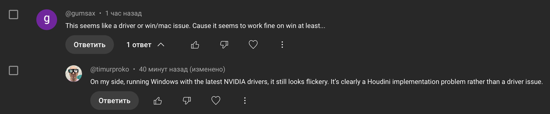

111 posts
Joined: 11月 2023
Screenshot 2025-08-27 at 21.18.30.png (97.8 KB)
スタッフ
5340 posts
Joined: 7月 2005
alexeyvanzhula1984
Flickery, as in they turned off VSync for Houdini? Hard to say what the problem is without more context. Ironically, the faster the frame refresh, the worse tearing gets with VSync off -- and Vulkan is quite a bit faster than GL, on average.
There weren't any reports of this during the beta or internally, so I'd recommend they check their driver against what's recommended, and submit a bug with their system specs if it persists.
