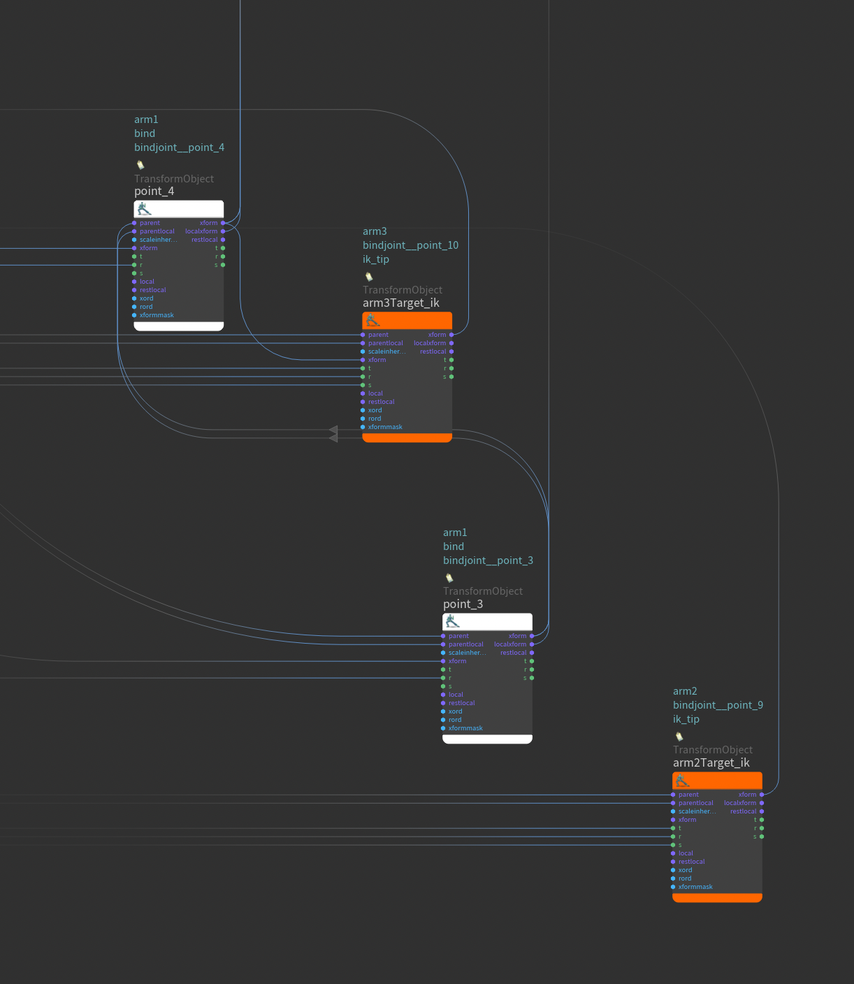

This is the APEX Network:
I created 3 different arm segments.
It creates an unholy mess once it goes through the APEX AutoRig Multi IK.
I have played around with the APEX graph to try and clean up including the multiple polevectors.
This sorta works, but once I try to attach the point_3 xform into arm2tarkgetIK the whole thing collapses. Point_4 xform to arm3targetIK xform does work.

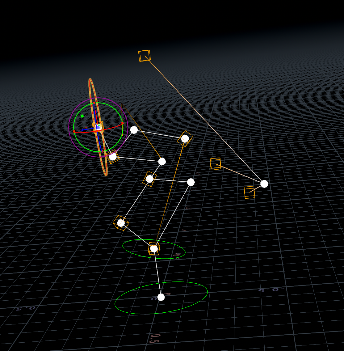

I'm making some progress. I've managed to get most of the rig to work but polevec doesn't work.
And the bone (point_7 -> point_8) stretches no matter what I've tried with my clearly limited knowledge.
I used the "transform driver" component source to create a bunch of parent offsets which is the only way I've been able to get the MultiIK to work.
If I could attach a video, I would.

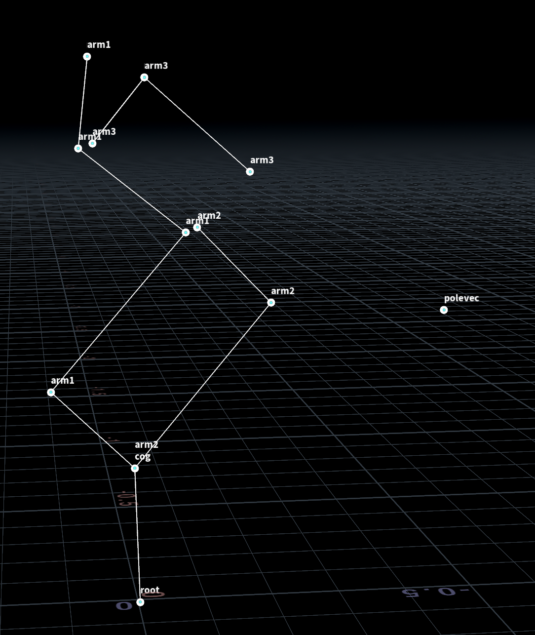

Hi, This looked like so much fun I wanted to join in.
Here is my setup for the little lamp.
I experimented quite a bit with the hierarchy, and added and removed joint chains until I got something that was working.
The right parenting is quite important in this setup, so I extracted the joints from the apex character, and used the parent joints node to make for a very fast setup.
Hope this helps
Hope this helps

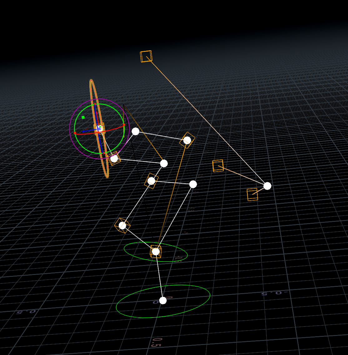

Woo Hoo! Worked brilliantly! Had a few quirks where apparently Jr has balls which I quickly resolved. Thought I'd post this for a laugh. I used different colors to figure out where the problem was happening.
This is with most of the geo fixed:
The springs I'll either rig up or do it for post animation along with the power cable. I'll create a few different setups.
